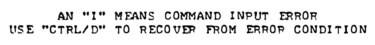

I get this 'I' before the new line and carriage return. (Which with the SCELBI are intended to be literal)
I tried different parity schemes but still saw the I. Dunno why. Also when it first started it printed some weird stuff before printing the '>'

I think the 'I' is some random rubbish going back to the SCELBI on the receive line:
It is not unusual to observe initial random characters using a bit-banged serial port.

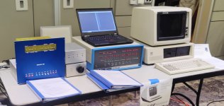

Also I'll post a picture of my table once it's set up today.
I hope the machines are behaving themselves!

I didn't want to jinx it, but all three systems managed to hold up for the whole show!
I'll definitely be interested to take a look at your work on this.
Excellent news. Sounds like you had a good time.
