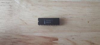

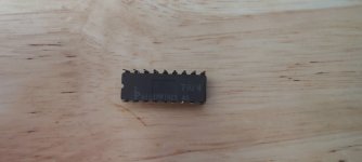

I put another D8008-1 in the SCELBI and it behaves identically to my other D8008-1.
The C8008 works fine. I believe C/D is just the package material so that shouldn't matter.
All are running at 500kHz. I wouldn't expect that an 8008-1 couldn't run at 500kHz.
So this will require further exploration.

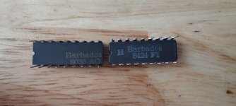

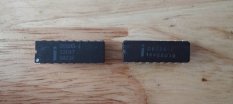

What other markings are on the two chips? There should be a 'lot' or 'date' code.
There is one horrible possibility. This is where an entire batch of devices failed due to a manufacturing defect and were sent abroad for destruction. They were never destroyed, and have found their way back into the supply chain.
The clocks are, to a tee, set as described in the SCELBI manual. I'll take a look in a bit to see if that varies from the datasheet any, but I doubt it.
Comapring them side by side, they are definitely different lots. Left is the one I've had for ages and right is the one I just got.
If those are date codes on the bottom of YYWW, then those are very late. The second one would be the same year as my 8088 powered IBM PC XT as well as my C64 even.

It is interesting that both of your 8008-1 devices were manufactured in Barbados. I see Intel did have a manufacturing plant in Barbados, but it seems to have had a bit of a 'checkered' history and seemed to have been closed after a wage dispute.
The only 8008x that I ever had that did NOT function at 500kHz was the East German 8008 copy. To be fair, maybe it did work but none of my 8008 machines have “strictly by the book” clocks and maybe it wasn’t as tolerant.
I have at least two ceramic Intel -1 chips from Barbados that work in my machines at 500 kHz. Haven’t done my 750 kHz tests yet.
It seems the D8008-1 was made only in Barbados and the Philippines with most in the US being from Barbados from what I can find on eBay, which makes sense. I just purchased a Filipino one for science though.
