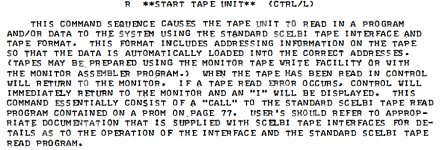

I've just gotten my tape interface built. I actually built the boards years ago, but only built the enclosure today. So far, the following is working:
1. Control of the tape player. Both the read and write commands in MEA will turn on and off the tape player
2. Tone recognition. If I use the read command, it'll continue listening until I start playing data, then it will eventually throw an error.
Which leads me into what's not working:
1. Reading data. I always get an "I" which according to the MEA manual means there was an error reading data.
2. Writing data. No sound wave appears in audacity when I try to record.
@kalinchuk mentioned in his video that @mwillegal had timing issues and needed to replace a capacitor with a different value. (I'm guessing in his blog somewhere)
I'm not sure though that that would cause my writing issues. Perhaps my reading issues. I'll need to break out the scope and look around I suppose.
But excitingly, that's some luck!

I have taken a quick look at the write schematic.
The input clock is connected to P1-10 (AH) and this should be wired to the CPU SYNC signal (XA02 B-A and B-B). This forms the master clock for the interface derived from the CPU clock. As a result, the CPU clock needs to be adjusted correctly - otherwise the interface frequencies will be 'off'.
There appears to be a number of simple dividers (7493) producing the frequencies for the two tones. The '0' and '1' tones are derived by Z6 on pins 9 and 12 (respectively). Pin 12 is from the /2 counter output and pin 9 is from the /4 counter output (hence a factor of 2 difference in the frequencies).
These two frequencies are fed into the logic comprising Z12 (wired as a 1 of 2 selector); so either the higher frequency or the lower frequency is selected (based upon the logic level of Z5 pin 10), divided further (by Z13 - /16) and output to the cassette recorder.
Z5 (7496) is a 5 bit shift register that can be parallel loaded. The serial input (pin 9) is permanently connected to 0V, the four (4) data lines are loaded from P1-1 through P1-4, with the fifth input (pin 7) being held permanently HIGH.
Effectively, there should always be a tone output from the write circuitry. It is possible that the logic powers up in a strange state and requires initialising. However, I can't see a power-on reset of any kind. This may account for the strange 'wailing'? The only way that anything other than one of the two tones could be realistically produced is if the tones are being 'switched' / modulated by data being sourced from Z5 pin 10.

The bottom notes are based on what I see in the Intel hex file. But I'm thinking perhaps this version of SCELBAL is different. Maybe a different revision. (It was labeled as 1975, and the one from SCELBI.com seems to be 1976? IDK) Anyway, I can identify parts, but I'm still confused. I don't even see data being loaded the same way after the header.
