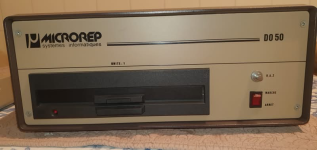

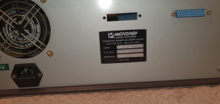

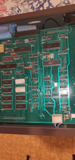

Hi there, I do have this Expansion but unfortunately not the Pc-8031. Any way to make it working with my PC-8001 ? The same person who sold me this unit has a 8 inches french disk drive unit with I think a controller inside including 6116 ram, 8085 cpu etc..
Any chance that they used to finally be working together in the past ? Thanks 1783764304929.png1783764325911.png1783764341145.png1783764407626.png
Any chance that they used to finally be working together in the past ? Thanks View attachment 1325207View attachment 1325208View attachment 1325209View attachment 1325210
is totally different hardware

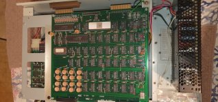

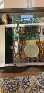

Hi,
Well it certainly looks from the outside like a 8031. Best to take a look inside, here are some photos of my 8031 and 8032 units.
The 8031 has the controller board and floppy drives, the 8032 contains just the bare floppy drives.
Regards,
John
