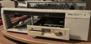

Hi guys
I'm still trying to create the floppy disks
I got the d88 dumps
these are dumps for 2s2d floppy disks
my nec pc-8031 drive is in 1s2d
I have 5"1/4 1s2d floppy disks
if I use a greaseweazle connected directly to an 8031 drive, could I create the floppy disks ?
side 1 contains no data
or maybe use a 2s2d pc drive to write the 1s2d floppy disk
I can also delete side 1 which no data with a tools utility
or take a gotek drive with the d88 dump and copy the files on a 1s2d floppy disk into a pc drive 2s2d
thanks all
You can't connect a PC/Shugart-style floppy controller directly to the 8031, it doesn't speak floppy drive on the external connectors (or at least not the 34-pin one for "FDC" – not sure about the ganged port for the third and fourth floppy drive)
You can remove the internal drives from the PC-8031 chassis and reconnect them to the Greaseweazle, but you might have to play around with jumpers for head load.
The drives in my 8031 are kinda spotty. I did eventually write up my entire ordeal with the homemade PC-8033 floppy controller, PC-80S31 and PC-8031 floppy disk drives but I still need to do maintenance on the 8031 drives and figure out why the 80S31 isn't acting right.
Greaseweazle will happily write just one side of a disk image for you if you specify
--tracks=h=0
I have the original 8033, so no problem connecting the 8001 to the 8031
as the dump is double sided, the driver having only one head the verification fails
I'm going to try to make the floppy disks with a friend's double-sided drive and the 1s2d floppy disks
