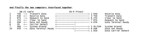

I just want to know how to set up serial transfers from the laptop to the Kaypro.
