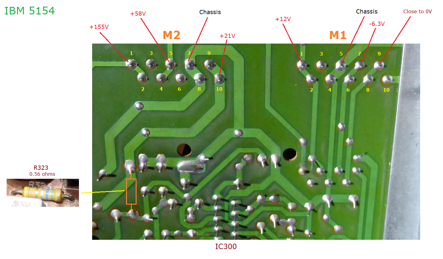

One good basic check is to see if the 5154's PSU output voltages are close to what they should be.
The diagram at [here] shows the voltages for my functional 5154.
( Safety warnings at [here]. )
@modem7 Good point out. Thanks for that. The DC power supplies are all ok.
