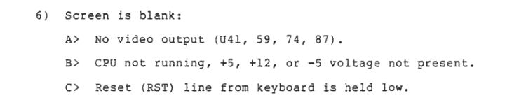

Also... reading the OP entry I see he got that display by tinkering - and it is not necessarily a bad thing depending on how he got there.
But a completely blank display on normal power up is covered in section 6:
The pattern on the screen is a good sign that the RAM is probably OK, but of course, that pattern is not testing all possible bit patterns in the RAM.
Having a completely blank screen sounds like the processor actually is running and wrote blanks to all of video memory during initialization, but for some reason, you’re not then getting the prompt. What happens if you press Return a few times after getting the blank screen?
Is it just an artifact of the picture you took, or do you only have 15 lines of characters instead of 16?
Mike D
I did some more checking here. I know the video circuitry itself works, I always get sync pulses out. There's just no video data when the screen is blank.
The supply voltages are all good, and ripple free. The reset line is not held low by the keyboard. I checked directly at the CPU pin 12, when normally operating reset pin is 0v. When reset is asserted by either the keyboard UC+REPEAT or if I jumper the reset pin on the PCB, the reset circuit goes to 5v for the duration of the reset being asserted.
Re: COMMON SYMPTOMS OF FAILURE.
Okay I totally missed this section in the manual... I will go back and review it more carefully.

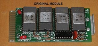

( My favorite module remains the one with the four MM5204's because they are are really vintage "classic parts" but very awkward to program without Martin's progammer, though there was a magazine article on how to make a home built programmer for these, but it is a painful way to do it)

When I made the personality module replicas with the four MM5204's , I did that copying one original ROM file at a time, but I checked that they matched the other online files for Solos, to be sure there was no data corruption, and fortunately it was ok and matched, despite the fact that the stickers over the windows on the original ROMs were fairly thin and didn't block all the light. I replaced these with sticky Alfoil (builder's insulation foil) so no light can get in and I use a Brother label machine to label them, so I never forget which one is which and for programmed ones.
Later on for fun, I used some of my replica modules to create a ROM S-100 card to put various programs on, one of the most useful isthe MEMTEST program. Of course the personality module has its own unique interface with the SOL, so to get these to work on the S-100 bus, requires additional chips:
