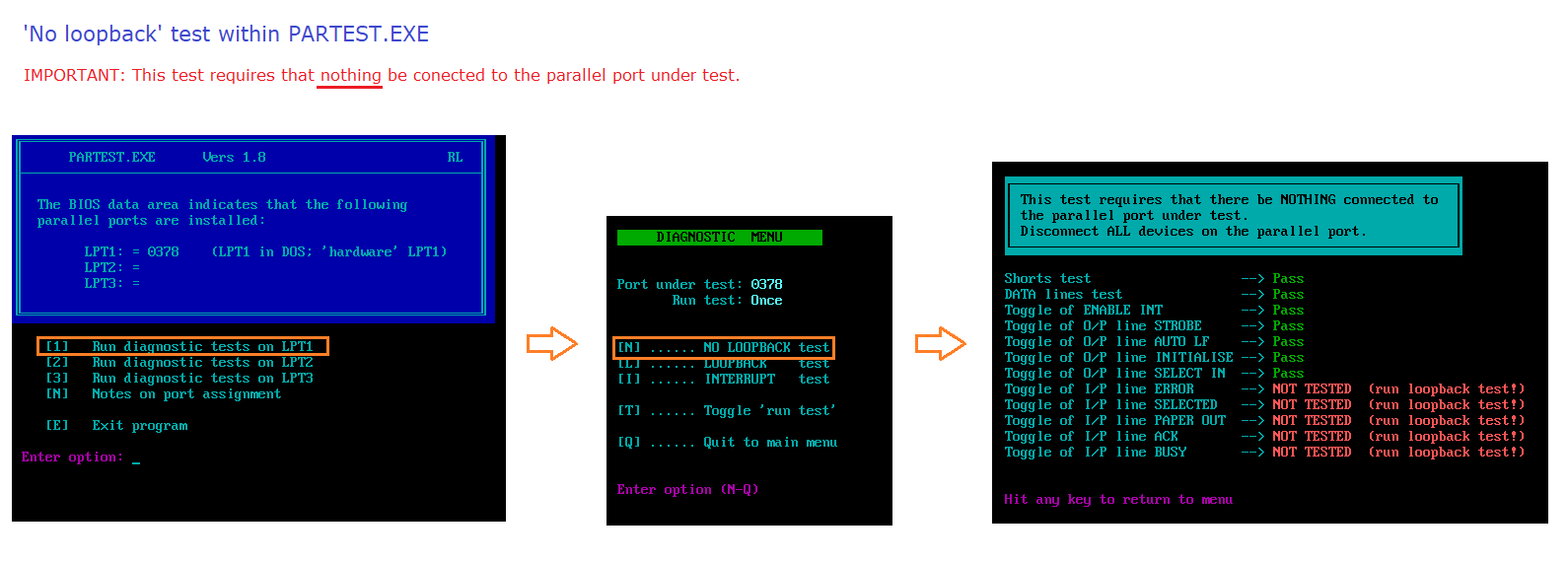

At [here] is PARTEST.EXE, a DOS based parallel port tester for IBM PC family parallel ports. Per the screen shots at [here], if you run the NO LOOPBACK test against the parallel port on the Hercules GB-112 card, do the four 'Toggle of O/P line xxxx' tests pass ?
