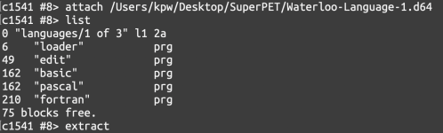

I used the “c1541” command line utility on my mac to extract the language files from the .d64 image. I think this utility is part of the vice emulator suite.
Yes, it did seem like switching from 6502 to 6809 mode after mounting the .d64 image file did do a reset as the 6809 mode didn’t seem to see the language files.
I’ll post a screenshot of the extracted file list as well as how the 6502 side displays them with the directory command.

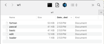

Pics attached show:
1) extract of waterloo language disk #1 (.d64) files using c1541 utility
2) mac finder info for the extracted files
3) Pet Disk Max directory with the original .d64 file on SD card
4) Pet Disk Max directory after mounting the the original .d64 image file from SD card
5) Pet Disk Max directory listing of different SD card with extracted .d64 files (via c1541 utility)
6) Failed 6809 load of basic from SD card containing extracted .d64 files (using b command)
