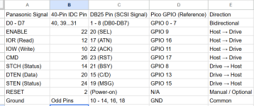

If we take something like a Blue SCSI (that already implements the SD interface, ISO interpretation, and Wifi interface) and just change the engine to a Panasonic engine from the SCSI engine, all we need to do is rewire the DE25 connector (at least on the devices I have) to the 44 pin connector. Something like this:
And maybe add one of the pins (maybe the DBs pin9 - normally SCSI parity) with a button to cycle to the next ISO image for now.
I think the protocol noted above is probably enough to get started if I can find someone who can handle the PIO programming of the Pi Pico and help get that started. We can reuse the bulk of the work that the community has already done and make this adapter and the framework from the BlueSCSI and get a kickstart, so to speak. That's my idea at least, if someone wants to help.
We can figure out the expansion connector next, but this might be a good way to start getting stuff on the device easily without making a lot of coasters.
Do you have any other sources on the pinout for the Mitsumi drive/interface?
It looks like the Panasonic one presents status bits on a few interface lines and the Mitsumi pinout linked doesn't have those at all.
I feel like you're assuming a lot here on compatibility, but I certainly don't have any VIS hardware. So best of luck with your efforts.
Apologies - I think I linked to the wrong bookmark - you're right, the Mitsumi one is different than the Panasonic one, and this is most definitely a Mitsumi drive. It's the predecessor to the LU-002S and LU-005S drives.
The Linux drive (mcdx) is here: https://git.whoi.edu/dgiaya/linux/-/blob/v2.6.18/drivers/cdrom/mcdx.c (This is the newer multisession one)
I believe the older non multisession driver is this one: https://git.whoi.edu/dgiaya/linux/-/blob/v2.6.18/drivers/cdrom/aztcd.c
Mitsumi Pinout: https://allpinouts.org/pinouts/connectors/data_storage/cd-rom-mitsumi/
This is the only mention of the FR drive that I can find: http://ubuntu.mirrorservice.org/sites/ftp.cdrom.com/pub/cdrom/drives/mitsumi.txt (It's at the very bottom) - note that it's February 1993 that Computer Shopper mentioned them.
