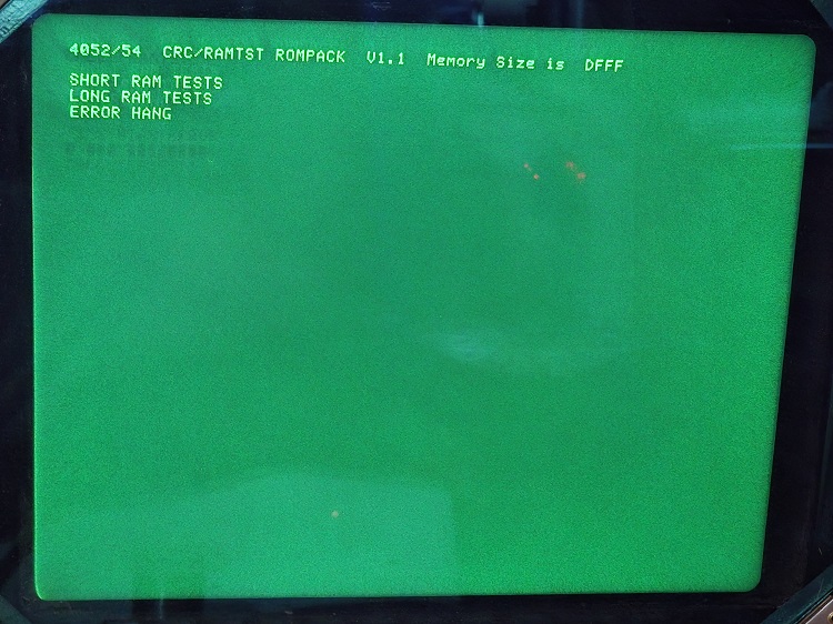

Update since July - I've replaced all the soldered DRAMs with sockets and found 1 more faulty DRAM. The diagnostics pack, however, did not quite pass the RAM tests perfectly, it'd complete but not print DONE. I tested the DRAMs again individually in a 4116 tester and double-checked they were good. Before troubleshooting further, I decided to wait until I upgraded the ROMs from v2.1 to v5.1. With Monty's help, I received a set of programmed 57C49's and installed them today. The system powered up to a blinking cursor so that's at least a good sign. I took a leap of faith and tried to load the GPIB drive. Ran into a system error! The v2.1 ROMs only gave me random GPIB IO errors, but never a system error.
I then set up the diagnostics pack to run the ROM CRC tests.... system went haywire after testing U880.
Shortly after that, the screen flashes and it prints a system error at the bottom.
There are no patch PLAs or ROMs installed on this board. Only the set of 8 57C49 ROMs.
What do the LED's on the Diagnostic pack say ? The original docu from Tektronix shows their meaning, but keep in mind that my reproduction has these LED's in the wrong order (right to left iso left to right)

Jon,
The SYSTEM ERRORs can be decoded - see my post: 4052/4054 System Error Messages
The first error occurs after using the Flash Drive to find and then load file 1 "Root Menu Loader" length 1427
  • The 00 means SYSTEM ROM, the 10Eh decodes to BASIC line# 270.
  • Line 270 in that file is:
    • 270 READ C$,T1,S9,T8
    • which is reading one of the DATA statements in lines 210-240.
When a BASIC program is OLDed into RAM, the BASIC ROM converts the data into 4050 format string or numeric SYSTEM variables.
The READ statement in 270 is simply copying the SYSTEM variables into USER variable names.
Simple BASIC operation - so I suspect you still have at least one flaky DRAM.
The SYSTEM ERROR is a fatal interrupt - and could be caused by a RAM parity error.
Have you run the LONG RAM test in the DRP?

Your DRP CRC list picture shows something very odd:
the line with U870B - should show U870A as in Jos Dreesen's post #1 with his 4052 v5.1 ROM CRCs in this thread: https://forum.vcfed.org/index.php?threads/tektronix-4052-54-diagnostic-rom-pack-remade.63974/post-63974
I will bet this is a RAM error in low RAM - might have caused a parity error when it was read and printed back to the display.
Maybe the soldered RAM LSB? Not sure which LSB - could be upper byte or lower byte.
DRP Long RAM test should find the bad RAM.
DRP Long RAM test appears to behave oddly, same as before, 4 out of 7 times I ran it, I get a "DONE" no problem. 2 times the RAM test finished but instead of printing "DONE", the screen flashes and the test repeats. 1 time the RAM test finished, flashed the screen, and hung - in this case, the DRP LEDs indicated an unexpected IRQ from the ALU or I/O.
When the RAM test completed and printed "DONE", I ran the CRC test and was able to get a complete listing with matching CRCs except for ROMs past U893.

Your ROM CRC test is now perfectly fine!
The 4052 Diagnostic ROM Pack firmware CRC results stopped at v4.3 and you now have v5.1.
This Service Note shows the v5.1 was the last version for the 4052/4054 and your CRC results match the entire list on page 18 for v5.1!
