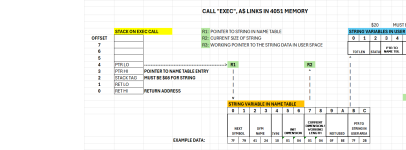

The 4051 DEBUG option ROM loads DDT into RAM in a string variable DIMensioned to length 5632 bytes as shown in this 4051 Emulator screenshot:
I got this information on how to access the 4051 DEBUG ROM with DDT and the 4051 Enhanced BASIC commands in an email from Micheal D Cranford - author of the 4051 Fast Graphics ROM, which was used by the 4050 firmware team to develop the 4052R12 Enhanced Graphics ROM Pack. The R12 demo tape files I recovered and posted were created by MDC for his Fast Graphics ROM. MDC also created the 4051 MAXIROM Pack and 4051 RAMPACK for the 4051 that had been offered by VintageTek museum a couple of years ago.
The major difference between the 4051 Fast Graphics ROM Pack and 4052R12 Graphics Enhancement ROM Pack was the change of the Fast Graphics ROM Pack MUZAKT command to MUSIC in the 4052R12. I accommodate that difference in a couple of my latest programs by differentiating whether the program is running on a 4051 and using MUZAKT as the CALL versus all the 4052/4054 will use MUSIC. Micheal designed his 4051 RAMPACK to support accessing large ASCII string variables (~28KB) differently than 4050 BASIC. I finally worked around the 4050 BASIC limitation by using BINARY strings instead of ASCII strings - which support strings up to 8KB on both 4051 and 4052/4054. My programs with images larger than 8KB R12 strings, simply break the image into BINARY chunks that can be displayed separately, and then the next 'chunk' or block is then loaded from the Flash Drive until the "|EOG|" string is read. In fact most of my R12 programs use much smaller strings - down to 256 bytes in size to smooth the display of large images to minimize the GPIB transfer delay affect of larger GPIB block sizes.
Examining my disassembly of the 4051 DEBUG ROM, it appears to not only relocate DDT v51.8 to RAM, but also does a couple of checks to make sure the DEBUG ROM is bank switched into 8800h and the 4051 BASIC ROM is also present.
My f9dasm disassembly of the DEBUG ROM has not been edited to properly ignore disassembly of data sections like the table with 6800 opcodes - so there are a lot of memory references and code references in those data areas based on f9dasm attempting to disassemble those data sections that I need to remove from the list of EQU statements and relabel the bytes as FCB.
I am working to correct those references now.
My plan for a 4052A/4054A DDT is to create a 4052 DEBUG ROM with ROM references updated with 4052 BASIC ROM entry points from the 4052A Assembler document.
I do see a CALL "EXEC" command in the 4052 v5.1 ROM, however when I type CALL "EXEC",A$ into my 4052 I get a parameter error. I would bet the 4052/4054 CALL "EXEC" is more similar to the 4051 CALL "EXEC" which used a short LOADER string that had 16 7-bit ASCII HEX characters 0-? for the loader as the original 4052/4054 BASIC was restricted to only support 7-bit ASCII characters - just like the 4051.
The A-Series BASIC added 8-bit ASCII character support and used 8-bit ASCII for CALL "EXEC",code$,rel$ parameters. I do think the 4052A Assembler documentation of the BASIC ROM entry points will also work on the 4052/4054 since most of the 4052 option ROMs work in both my 4052 and 4054A. Only the 4052R14 and 4052R14-1A GPIB Enhancement option ROMs are specifically marked for 4052 or 4052A -which makes sense as the A-Series GPIB hardware was based on the TI9914 GPIB IC and the original 4052/4054 GPIB was the same discrete logic design as the 4051.

Based on your work on the Name Table, I know that the 4051 EXEC call is not officially documented, however, between the 4051 firmware and the CALL EXEC document you have identified before, I think I have an understanding of the code used for the call.
The code only considers one string placed on the stack by the calling program, but the CALL EXEC document hints that additional strings can be stacked to allow the small program in the scratch pad area to then locate a second string variable and call a larger program by chaining to it.
The CALL "HEXEC",<String> function call might be a bit simpler, I need to look at that code.
Attached are my comments on the disassembled code, along with a diagram to follow the pointers.

Monty:
