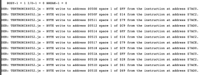

I think I have found an (the) anomaly...
Funnily enough, the 4052 emulator has been telling me all along that something was wrong! I have just been ignoring it...
I can now see the code that is trying to set-up the PIA table for use by the interrupt service routine. However, the SDA instruction (Set Data space A) appears to be working sometimes and not others. As a result, the data that should be written into the table is being written into somewhere else... I can see the code writing the PIA addresses FF14 and FF16 (X-AXIS PIA) and FF28 and FF2A (keyboard PIA) but to the wrong locations. The problem is actually reading the X register that it has previously stored into RAM at address $1A. It writes into RAM at $1A and $1B but then reads from non-existent ROM at $1A and $1B - reading a default value of $0000.
The subsequent data writes do actually write into RAM, but now at the wrong address (because X was rubbish).
OK, having found that, I need to go looking after I have now done the washing up. I keep getting a funny look from the wife because I promised to do it a while ago!
The PIA table in the 4052 starts at $050E.
I may have found the culprit...
The 'D' flag is being changed just after the instruction that uses the new value has executed!
I assume the same issue will be applicable to the 'F' bit.
It appears to be a microcode state machine timing issue.

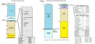

I just updated my 4051-4052-4054 Address Map for the following changes:
I found that ALL the BASIC ROMs for 4052/4054 and 4052A/4054A have a table of all the BASIC ROM assembler CALL entry points at 4000-43FF, from the 4052A Assembler document that I posted in my repository - and from examining my 6800 disassembly listing in my previous post in this thread of the 4052/4054 v5.1 ROMs that Dave is using in his 4052 Emulator.
Therefore the ENTIRE 4000-FFFF range of the BASIC ROMs in ROM space is used in ALL the 4052/4054 and 4052A/4054A models - including the 4052/4054 ROMs with earlier firmware than v5.1 with Patch ROMs.
The 4052 and 4054 models including A-Series have the same set of ROMs - and the specific model is auto-detected by the ROM code.
There is BASIC ROM code in the 8KB CONSTANTS ROM at E000 in the RAM space, so I updated the description of that ROM, so the 4052/4054 have 56KB of BASIC ROM.
The 4052/4054 BASIC ROMs are much larger than the 4051 BASIC ROMs for several reasons:
  • 4051R01 Matrix Functions option ROM Pack is included
  • 4051R05 Binary Program Loader option ROM Pack is included
  • 4054 differences for 4054 Display and Vector Generator
  • 4052 Option 1 RS-232 COMM ROM support is included (there is NO ROM on the 4052/4054 Option 1 schematic, these CALLs are in the 4000 ROMs)
  • 4054 Option 30 Dynamic Graphics ROM support is included (since the Option 30 board has no access to the option ROM bus)
  • 4907 Floppy Drive system or 4052 Expanded Memory CALLs in the E000 ROM (at least these are in the 4052 v5.1 ROMs I have disassembled)
The 4052A/4054A added an additional 16KB BASIC ROM at 0000 containing the new 4052A/4054A ROM CALLs for structured BASIC and other new A-Series BASIC commands that can be bank switched out of the ROM space for a total of 72KB of BASIC ROM!
I also posted this updated Address Map in my repository.

I have added copious amounts of debug code into the 4052 emulator this afternoon and found that the emulator is both working and not at the same time (in a superposition of states)!
I think that the sequencing of operations is not 100% correct (well, I have a bug) so I suspect I am going to have to re-write the microcode emulator section itself. Well, not re-write it, just make sure that the sequencing of everything is correct.

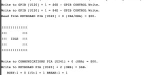

I know it doesn't look like much, but here are some of my diagnostic messages where the PIA table is setup in RAM...
You can see the FF14, FF16, and FF28 entries being created.
And the IRQ handler even responds with some more of my diagnostic messages when I type a key on the keyboard:
I can even type multiple keys, and the IRQ still responds!
I even get the following displayed occasionally on the emulated screen!
It doesn't look like much - but I have been waiting for this event for a while - type a key and get a vague response! To have the correct character displayed that I typed is a bonus! OK, the emulator is a bit shaky yet...
I had been a bit of a silly bug*er!
I had attributed an emulator diagnostic message to this fault when it was nothing of the kind...
It was the firmware probing the optional bank switched ROMs that was causing my diagnostic messages to be produced.
I moved the code that updated the CPU status flags (latch U385 on the ALU board) a bit further up my code - so that the latched flags had been updated before the next instruction (including the operand - a very important step) had been fetched and partially executed. I had updated latch U385 after the instruction's operand had been fetched - but not before. The 'fix' caused the PIA table to be correctly constructed in RAM, but I was fixated on the emulator diagnostic message that had nothing to do with this fault. I (basically) confused myself into thinking the fix had not worked when, in fact, it had!

I tried LIST on its own, and got a more comprehensive system error this time...
This looks more like the error in the Tekniques article.
We are (however) getting into the IDLE loop. I added a diagnostic message when we first hit address $626B:
I will have a look at the X and Y spacing tomorrow also.
My decode of the last set of HEX digits: 00 0848 08 indicates:
Nonsensical Line number 2120
00 is the Bank Switch ID of the System ROM
And since your just typed LIST - it says the error occurred in the LIST command
The CCRF flag is latched by U661A on the MCP board when the PC is loaded from the ALU output. I may need to implement this bit of logic, otherwise (when I change the F bit in the condition code register) the change will take place instantaneously rather than waiting for a BRAnch to occur. If I get it wrong, the CPU will start fetching instructions from the wrong space, and will end up invariably crashing the machine. This looks a relatively simple modification to implement.
