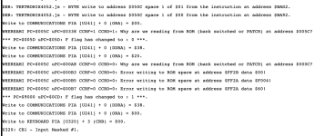

I added some debug statements to see what is going on with the F flag though.
The F flag is set to 1 by the microcode before executing any instructions.
The start-up code and keyboard interrupt (in fact nothing) then plays with the F flag UNTIL I press the <return> key.
The F flag is reset to 0, and this coincides will all sorts of mayhem breaking out!
I suspect this is the next flaw in my 4052 emulator to fix...

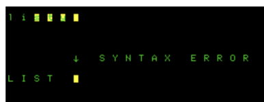

I typed 'listy' instead of 'list' and received the following error message (this time as expected):
Ignore the 'yellow' blocks. They are the un-erased cursor...
This time, the F flag was not changed - and the code survived! So I am definitely on the right track with my 'delayed F flag' modification.
The coordinates for the alpha dots appear to be drawn correctly though - so there must be something outside of my screen drawing code somewhere.
The 'L' is drawn at X=0 Y=767. The 'I' is drawn starting at X=14, Y=767.
'S' at X=28, Y=767.
'T' at X=42, Y=767.

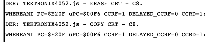

I have just spent an hour or two 'playing' with the latest 4052 emulator and I am noticing a few strange occurrences.
For example, when typing LIST, I get part way then the screen erases. I have some debug code that I enabled, and there is a whole load of ERASE CRT and COPY CRT diagnostic messages output:
The Key codes of 49 and 53 is the 'I' and 'S' of LIST respectively. The code has spotted the release of the 'I' key and the depressing of the 'S' key. It then proceeds to do some 'strange' things with the PIA to initiate COPY and ERASE actions?
The microcode (uPC) is implying that we are in the IRQ part of the microcode - and hence (my guess is) the code should be saving the registers into RAM rather than playing with PIA!
The emulation does, however, appear to recover after this - which is why I possibly never noticed it before.
Let me play more...
Possibly another subtlety of this pesky 'DELAYED_CCRF' flag?
CCRF=1 means ROM space.
DELAYED_CCRF=0 means RAM space.
I wonder if there is a signal to clear (or override) this pesky latch under certain circumstances?
