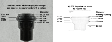

You can see the Faber Castell pen in my 3D printed pen adapter installed in the plotter for that plot.

Next photo shows the Staedtler pen adapter I created to the left of a Tektronix pen and adapter. On the right is the Faber Castell Pitt Artist Pen and adapter I created.
I had purchased two different Staedtler HP Plotter pen sets 20 years ago. Almost all these pens still work. Secret seems to be storing them capped and horizontal.

I have posted my 3D printed plotter pen adapter STL files on my github Tektronix program repository in a Tektronix 4662 folder:

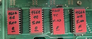

Here are the handwritten EPROM labels on the one 4662 plotter. That one also has a small ATN/DAV HOLDOFF board wired to the main PCB.

The 4662 plotter pen twists into the pen mechanism - so my 3D STL adapters cannot be used with replacement pens.

I compared the profile of the Tektronix multi-pen adapter with my 3D printed Faber Castell adapter and I see room for improvement on my 3D printed pen adapter.

I remeasured my Tektronix 4662 multi-pen adapter with my Mitutoyo caliper and see several differences on my 3D printed Faber Castell pen adapter that might be responsible for the pen skipping.
Here are my measurements compared against my 3D printed adapter:
Here is the side view of the 4662 plotter pen holder with the empty Tektronix 4662 adapter inserted:
I am counting the 'rings' on the Tektronix adapter in my list below.
  1. I am missing the top ring of the Tektronix adapter - but that ring is above the pen holder - so not needed on my adapter
    • HOWEVER - the 4662 pen holder does clamp the adapter on the second, third and fourth Tek rings and the angled slope between the third and fourth Tek rings
  2. Problem 1 - my STL thickness of the 'second Tek ring' is 2 mm while the Tek adapter is 1.75 mm
  3. Problem 2 - my STL height of the 'third Tek ring' is 2 mm while the Tek adapter is 0.75 mm
  4. Problem 3 - my STL thickness of the 'ramp' below the 'third Tek ring' is 1.5 mm while the Tek adapter is 1.25 mm
  5. Problem 4 - my STL thickness of the 'fourth Tek ring' is 2 mm while the Tek adapter is 0.75 mm
So I need to create a version 3 STL for Faber Castell pens - I plan to edit my v2 STL
I couldn't edit the STL file in Fusion 360 on the non-commercial hobbyist license. I had created the STL using Autodesk 123D and when I looked at my v2 file I discovered the hole for the pen was way too big for a Faber Castell pen - maybe I was trying to design for a different pen?
Anyway I saved that file to a v3 files and edited the outside shape to match my latest caliper readings, but I still need to fix my 3D printer.
zip of the v3 file attached to this post.
123D Design view of the v3 Faber Castell pen design:
