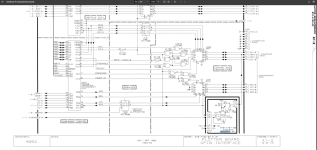

Here are the handwritten EPROM labels on the one 4662 plotter. That one also has a small ATN/DAV HOLDOFF board wired to the main PCB.
Interesting little board labeled ATN/DAV Holdoff.
I looked this up in the 4662 service manual 070-1933-01_Tektronix_4662_Interactive_Digital_Plotter_Service_Manual_Jul83.pdf and I see a schematic for this board on sheet A1-2 of the 1983 manual and it indicates the schematic is for main board 670-4102-02 and up. My main board looks like yours but without the bodge board and wiring.
Reason I am interested in this ATN/DAV board is the description in the service manual for this circuit:
This may be the reason my GPIB Plotter program hangs when my Flash Drive is quickly being accessed to read file headers.
The Flash Drive ATMEGA 1284 CPU is faster than the 800KHz Motorola 6800 CPU in the plotter, and my 4054A uses the TI 9914 GPIB which is blazing fast, so the plotter code doesn't have enough time to process the ATN sequence to determine whether it should respond.
Looks like I may need to breadboard the ATN/DAV circuit and modify my 4662 main board to add a hardware delay after every ATN sequence :( so the plotter CPU has enough time to process the primary and secondary address.
Here is the schematic page - too bad they don't show the circuit before this mod, but it appears this board is wire-ORed to NFRD to keep it asserted low for 3 msec when ATN is asserted and reset when the A/DENABLE-0 signal is asserted by the GPIB REAR PANEL SWITCH A is high.
I am ordering the parts to build a breadboard of the ATN/DAV HOLDOFF circuit, but I cannot identify the 0.47uF C2 type of capacitor.
Although this HOLDOFF board is in the schematic, I don't see the parts list in the service manual.
Anyone hazard a guess as to what kind of capacitor I am looking for? @daver2
I am ordering an 0.47uF 5% tolerance 50V metallized film capacitor and a 23.2K 1% metal film resistor along with the 7438, 74123 (although I see 74LS123 on @glitch's PCB) and an 0.1uF ceramic cap for the HOLDOFF board.
I am ready to wire up a breadboard of the ATN/DAV circuit - but wondered how the board was connected to the main Plotter board.
Here is the Plotter board layout diagram in the corner by the GPIB connector:
I yellow highlighted a screw that must be used for ATN/DAV board mounting.
The ATN/DAV schematic in the lower right corner of page A1-2 shows the board is connected to (based on @gslick ATN/DAV board photo)
ATN/DAV Board signal connector P1 Pin / IC and IC pinPlotter Board IC & Pin / signal name

Table 4-6 in the 4662 Service Manual contains the following information for the ATN/DAV Holdoff connections to the 4662 plotter main board.
I highlighted the A/DENABLE-0 text in GREEN.
P1 Wire color in @gslick photosATN/DAV Board signal connector P1 Pin / IC and IC pinPlotter Board IC & Pin / signal name
BROWNP1-1 / GNDU205-8 / GND
REDP1-2 / U3 pin 3U205-7 / NFRD-0
ORANGEP1-3 / +5VU205-16 / +5V
YELLOWP1-4 / ATNU101-10 / ATN after debounce buffer
GREENP1-5 / ATN/DAV board ENABLE-0U201-9 / A/DENABLE-0
REAR PANEL ROTARY HEX SWITCH A bit 4 schematic pg A1-1
(this bit previously unused for GPIB)
SWITCH A Bit 4 MUST be ZERO to ENABLE the ATN/DAV mod.
Set SWITCH A bit 4 = 1 to DISABLE the ATN/DAV mod.
The service manual page 5-16 describes the circuit and says when SWITCH A bit 4 is set high (true) - this ATN/DAV Holdoff board is enabled.
