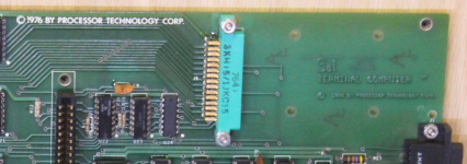

I think I'm almost ready to send this out to PCBWay or such. I always figured the last 1% would be 99% of the work - it's mostly just trying to get the board to resemble the original as closely as possible. It'll never be 100% accurate as the scans are poor quality and I struggled to get both sides of them to align correctly, but it'll be pretty darn close. KiCAD has had quite the learning curve, but I'm surprised at how close I've actually gotten. I could just print these off and do the toner transfer dance... but that means 900+ vias to connect from side to side.
Right now I'm just putting in smoother curves to match the hand-laid ones on the original, trying to align them as best I can with the original artwork. And I'm still finding the odd connection to various pads that I missed, because the gap is so small it's hard to see. Also, it's really hard sometimes to tell how thick a trace should be, because the scanning process produced noise that distorts the tracks and sometimes makes them look wider than they might have been.
I'm thinking of going with PCBWay to produce this, as they are the only fab that has been even willing to entertain my desire to have this etched on some vintage original PCB stock I have (after I do a prototype run), to further ape the look of the original.
Still working on the schematic too - that is going to take ages though as again there's a huge uphill learning curve for a non-EE, non-pro KiCAD user like me. I have to modify every IC symbol to match the schematic to have even a prayer of getting it right. I'm at a point where honestly I'd almost prefer to just print it out large size on my designjet and just do my best to work out the obscured stuff like IC numbers that were scanned badly. What I wouldn't give to find the guy who provided the originals to scan to see if we could get better results 20 years later!
Once this is done I will convert it to 4 layer, and assuming I figure out the missing connections, I will then note those on the schematic and try making them on the inner layers for neatness.

I'm wondering about the 4 layer idea. It is better from the technical perspective in that really good ground and power supply connectins can be put in the two middle layers, and it simplifies the design of the top and bottom layers. But it does raise thecost of the board manufacture and middle layer errors in a prototype can be very awkward (as I once found out)
Since you are making a replica board, it would be advantageous to make it just like the original, and then you could use the original board pattern to check it in an image overlay scenario.

Be sure to include "REPRODUCTION" on the board, also the Rev. too, so people are well assured it's not an original.
Yes I was reading up and I understand that's kind of normal practice with the middle 2 layers apparently. However if I did that, that would necessarily change the visual appearance of the board on the top and bottom layers, right? My goal is to make it look exactly like the original on the top and bottom side. Which, even Lee Felsenstein couldn't understand my devotion to. :)

Yes I was thinking I should probably do that too. That's one of those ethical dilemmas, because I want my own personal one to look exactly like the original, but also don't want people being misled down the line.

I suppose I could put the word Reproduction in a spot along the ground plane on the outside.. that way if someone tried to remove it, it would leave a noticeable 'hole' there..
If the goal is to look like the original then why would you want to use a four layer board to make the original "work right" instead of using the masses of jumper wires the original would have required to do the same? I guess scrolling back through the thread we kind of hashed this out already around page 8... but I guess I'm still a little confused. Is the goal here to have a board that looks like the (we have to be honest here, the train wreck of an unfinished project) that was the original published board, but has a working S-100 slot like the final SOL-PC without having to do all the manual patching?
My main goal is to build one fairly exact replica (accepting compromises where I must) of the original Sol prototype that CHM has, for myself. I'm not really big into retro/recreations *except* in situations where I'm replicating something I can't buy otherwise (ie the TV Typewriter, before I lucked into a real one much later). I also really like the challenge of trying to figure out what materials they used, who made that orange can capacitor, etc. and getting it as close to a perfect copy as I can. It's like one big puzzle. Anyway, that's first goal.
