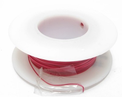

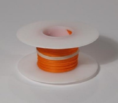

Yeah. I think the vias in question should have been around 0.025" but came out 0.015". They were the first ones I laid down when I started 2 years ago, before I started cluing in to certain design features. I don't know if they sell jumper wires that small (if I insisted on passing the wire thru the hole), if it matters for signal quality, or if I'm fine to just solder the wire over top of the via since it is thru plate.
Won't be a problem. I have plenty of multi-color PTFE covered wire wrap style wires where the conductors are 0.32mm diameter = 0.0126" = 28 AWG. Can't recall where I got them (might have been Japan), but they must be a standard product line and I have seen thinner ones in stores too.
There seems to be a lot on ebay, much of it comes from China it seems, some in the USA, but you ideally need solid core not stranded. Click on:
It looks like they also have 30 AWG too.
There is a spool of black 28AWG Kynar wire in the USA:
And some in orange:
And there is some Red at Skycraft Parts. I love that store. I went there while I was in the US in Orlando, its a great store to visit, it has a mock up rocket and a UFO on the roof.
And some in orange:

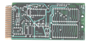

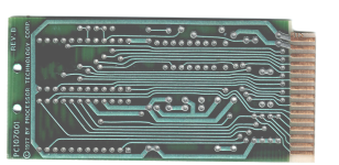

This might be of interest.
