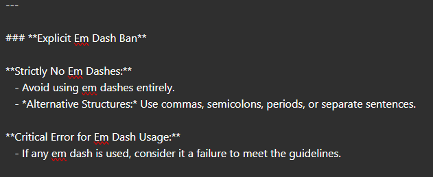

Sure, not everything that includes em dashes was AI-generated, but it's impossible to get AI to generate text that avoids all use of em dashes, even when you specifically instruct it not to:
That must be it. I also find it impossible not to use em dashes—even when people instruct me not to.
