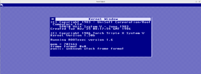

It validates the key diskette and loads the kernel as seen on the screenshot, but hit mmu bugs.
680x0?
If you're using the Musashi emulator core, check out the fixes Sprite_tm did to it for their Plexus P20 emulator. There's at least one bug in the exception stack handling which they fixed. I keep meaning to pull that fix into FreeBee and see if it removes the need for the supervisor paging bodge.
