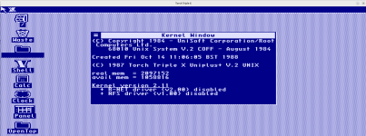

The mouse is not working yet, so I can not test anything further. Your image doesn't work with 1MB of ram, it requires the Limpet board emulation. I'm using Mushashi as a base + AI code agent :)

Fantastic! I've got it running to the point it needs the keydisk so I need to convert my HFE format keydisk to IMD but that will have to wait until this evening when I finish real world work.

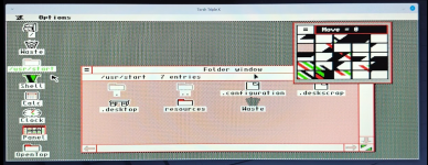

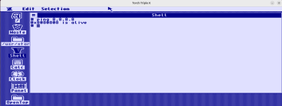

I got it all up and running fine. I took the liberty of changing the palette to be more like what the default OpenTop palette is (basically black, white, red and green). I struggled a bit with the network but that was down to my errors, and I still have to work out how to handle the floppy drive but it's almost exactly as the original. My own disk image also works fine (as seen in the attached picture).

Is there any way to correct the aspect ratio of the picture? <- Ignore this one! I figured out a couple of things in SDL and I have it working at a better height and also switchable to full screen.
I noticed that the startup doesn't run through the animation of the Torch logo. On the original, 'Torch' appears followed by a black, red and green stripe appearing from the top of the screen. During this period it's possible to click the 'STOP' icon and carry out some basic management functions. I did wonder if it's just because the emulator is running on a much quicker host machine. Would injecting some mouse input using the command line help with that as it would be good to see if the disk management features work?
I had no idea what the original palette looks like, so I've used what I've seen from your original photos in the thread — it looked kind of bluish to me :)
It does appear for a brief period of time, may be we should slow down the emulation.

Here's a video snippet showing the startup animation. It was taken from the Torch CRT monitor so has some flickering... And a screenshot showing the utilities available at startup. 😁

The X animation hasn't been shown due to the emulation's speed. Do I need to click the Stop icon in order to get the other menu options?
Yes. If you click 'STOP' with the key disk inserted it should go to the options shown on the screenshot.
If you click 'STOP without the key disk inserted it asks for the key disk. 😁
