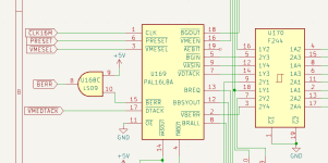

I have a horrible feeling that without IC169, it won't boot at all. I need to 100% confirm by removing my Limpet but I never got the thing to start without the Limpet installed but that could be because once it started to work (following my improvements to the power cabling) it had the Limpet already installed and I've not removed it since. But looking at the schematic it does look like IC169 is 100% to do with the VME interface to the Limpet only.
So for IC169 the /OE is held low anyway, pins 2, 5, 7, 8, 9, 12, 13, 16, 18 and 19 go the VME interface, and pins 14 and 4 head toward bus control for the VME, so it looks to me like the only pin that could stop things working is 15 /BERR. I'm no hardware engineer but I wonder if you held the '/BERR' signal high i.e. false, then it might work since, to my simple brain, that seems to be the only line that could impact the operation of the system. :unsure:

@RobColeman sadly, I can't get my board to boot without the Limpet board plugged in. I'll double check and see if there are any jumpers that are telling the board it has extra RAM but I think that without IC169 it won't work. 🙁
I tried just removing the Limpet which effectively removes IC169 and IC132. It didn't boot (not surprised on that one!).
Then, I removed IC132 from the Limpet and put it directly in the socket and tried to boot but with no luck. I just get the 68010 timing out error beeps.
So then I tried tying pin 15 of IC169 socket to Vcc and, to be honest, there's a flash of picture distortion that looks similar to the Limpet board RAM check. But no boot.
Then I tried tying pin 16 of IC169 socket to Vcc but just got the same. And also got the same trying to tie pin 3 to Vcc.
So then I went for broke and tied pin 3, 15 and 16 to Vcc but no luck. It refuses to boot without the Limpet. With the Limpet reinstalled it boots fine. 🙁
And, of course, I suspect none of us have actually got IC169 as we've all got or had a Limpet at some point. Darnit.
That's a shame but thanks for testing it. I did a bit of reading up on the VME bus signals and had a look at the schematics yesterday. I think the equations for IC69 should be fairly easy to recover if only we had a working example!
@kokoboi has IC169. :) I can see in the motherboard pic that was posted and I commented on it too.
