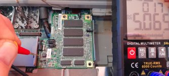

@Wappynutter, I would like to ask for your help again. I have replaced the electrolytic capacitors in the laptop and installed Windows 95, but I’m experiencing a strange issue.
The symptoms: At 800x600 resolution with 16 colors, it works flawlessly. However, if I switch to 256 colors, the screen becomes garbled with stripes during Windows boot, and the laptop freezes. Interestingly, if I let it sit in the BIOS for about 8 minutes before booting, the higher color depths work perfectly. It’s not a capacitor issue, as it behaved exactly the same way with the original ones.
I measured the voltage on the KM416C254 VRAM ICs (marked in blue), and I’m seeing a drop that I suspect is causing the instability. Meanwhile, the NDS9936 MOSFET shows a stable 4.95V.
My measurements on the VRAM VCC:
Power on: 4.88 V
BIOS / RAM test: 4.78 - 4.80 V
Windows boot (when it freezes): 4.73 - 4.76 V
Stable operation (after 8 mins wait): 4.76 V

Could you possibly check the VRAM VCC voltage on your working unit to see if it’s also this low?
Where exactly do the VRAM VCC pins get their power from? It doesn't seem to have a direct connection to the NDS9936.

Hey szelda, hope you are well. I'm having a break from my repair at the moment due to a lot of projects I'm working on including consoles, modern type AIO systems, older base units and even a commodore 64 and an old 300watt psu needing a recap.
Saying that, I took 20 minutes out of my hobby time to check on 2 of my 3 Toshiba systems for you.
Firstly I checked the 110ct and found this result.
Not to dissimilar to your readings.
Then I checked the 210cs.
20260429_110156.jpg20260429_105959.jpg20260429_110009.jpg20260429_110017.jpg20260429_110028.jpg20260429_110035.jpg20260429_110049.jpg20260429_110100.jpg
So 4.8volts seems to be the norm.
You asked where this voltage gets generated from and testing in continuity mode vcc pins go here..
Pin 3 on the connector on the bottom of the card. This connects on the motherboard here..
Pin 3 on the motherboard. I traced this pin to here..
A 5volt electrolytic cap next to the power button near the regulators etc..
Hope this helps. Maybe swap out the cap incase it's leaking or failing as it warms up.

@Wappynutter Thank you very much for the help and the measurements. I’m doing well, and I hope everything is fine with you too! Good luck with all those projects! That’s a serious lineup!
Regarding the laptop: I have already replaced all the electrolytic capacitors with polymer types, but I don't think the fault lies there. I also experimented with a custom RC filter and extra buffering on the main input, but the voltage drop on the VRAM VCC rail persists regardless, so input noise is likely not the bottleneck.
My next plan is to trace the power rail back from the 100 µF buffer capacitor located next to the power button. I want to map out exactly where the 5V originates and which active components (PWM controller, MOSFET, inductor) the signal passes through.
I suspect the fault is within this section, as the continuity between the buffer and the VRAM pins is solid and the resistance is negligible, so the PCB trace itself is not broken.

So I have been unable to find anything on the main motherboard so far but have amended my displayboard pictures to take into account all the small smd capacitors that have continuity with the vcc pins on both sides of the displayboard. I found no direct connection to any of the ic's while probing.
All red marks show points of continuity on my 210cs.
Hope this helps further. Maybe one of these caps is causing the power discrepancy.

@Wappynutter I’d like to share my latest findings regarding the VRAM VCC rail, as I believe I’ve successfully localized the cause of the system freezes.
Testing Environment:
The VRAM VCC rail is supplied with 5.08V, which passes through a 20 mΩ shunt resistor and a 1BL3 (Schottky) diode before reaching the bulk filter capacitors. Measurements were taken with a multimeter (I am aware that high-speed dynamic transients would require an oscilloscope for full accuracy, but the trend is clearly visible even here).
Measurement Data (Voltage Drop Across the Diode):
  • Cold start (after 8 mins of warmup): 0.250V – 0.252V drop.
  • At operating temperature (after 20 mins): The drop decreases to 0.240V (consistent with the negative temperature coefficient of Schottky diodes).
  • At the moment of freezing: The voltage drop spikes to 0.263V – 0.271V.
Based on my calculations, the voltage reaching the VRAM is exactly the source voltage minus the diode's forward voltage (V_f). The diode itself isn't "faulty" in the traditional sense, but its characteristic curve cannot handle the dynamic load. There are no other significant voltage losses on the rail.
Conclusion:
In my opinion, the issue is caused by the transition to polymer capacitors. Although I have already reverted most capacitors on the 5V, 12V, and 15V rails back to standard electrolytic types, the system remains unstable. It is highly likely that the remaining polymers' ultra-low ESR causes sharp current transients that pull down the voltage across the diode whenever the VRAM demands a sudden burst of current. This momentary dip is enough to exceed the VRAM logic's tolerance, leading to a crash.

I am looking for an Ultra-Low V_f diode, preferably a Trench Schottky (e.g., PMEG or V10P45 series), which can maintain a more stable output voltage under load and during transients.
Has anyone else encountered a similar "diode bottleneck" when using polymer capacitors in a legacy circuit?
Good luck with the diode and capacitor swaps. Hopefully this will cure your slight voltage drop underload. I am surprised that such a small amount triggers freezing and graphical errors. Share if you have any pictures so I can compare voltages if required. Keep us informed of your findings and repair log. Continued success repairing the Toshiba.
I really hope this is the root cause of the issue. For testing purposes, I'm going to try both a 30SQ045 Schottky diode and an LM74610-based ideal diode module. I will definitely share my findings once the parts arrive in a few weeks. Thanks! 🙂
