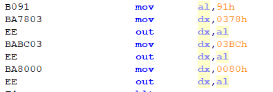

I am trying to fix a Toshiba T3100. It shows error code AA on the screen which, according to maintenance manual, is "DMAC #2 data bus error".
Toshiba laptops also output error codes on LPT1 port, and with "Printer Port LED" I am getting the same error.
As I am not familiar with this error, I am trying to locate in the BIOS rom part of the code where this is actually output to parallel port, and start troubleshooting from there. The idea is to see what BIOS checks before it outputs the code, and why is it not happy :) However, I cannot locate it, although I found lot of other places where some other codes are output to parallel port. For example:
I was able to locate in the rom, where the error message is stored, but I cannot find where it is used :(
I would appreciate any help in finding the code snipped, or any kind of explanation about the error, or an idea what bios could actually test for DMAC.

Attached is a interleaved rom from both BIOS roms.

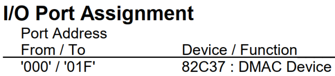

Do you know if DMACs have some well known I/O addresses? Like 64h for 8042, for example.
Of course, it is up to the motherboard maker as to which I/O ports are used for what.
For compatibility reasons, Toshiba may have used the same I/O port ranges as used for the IBM AT:
0000-001F used by DMA 1 (first 8237)
00C0-00DF used by DMA 2 (second 8237)
A breakdown of those two port ranges is at [here].

@modem7 I've already found few of "out" instructions in the rom that points to some of the I/O addresses in these range, and assuming that it is the same for T3100 as they used for T1200, probably for IBM compatibility as you've mentioned. This breakdown is really useful!
