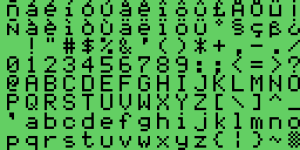

The monitor rom is one for Kaypro II/IV (81-232A). Nothing unusual there.
The char ROM (81-234) is like this:
whereby the first two line, which often have Greek characters, are replaced.
I dont think either factor is involved in this problem. I will explore using pip from the distribution diskette, and sysgen that produces one line and get back to you later.
