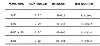

The CP/M version 2.2f and beyond are for the Kaypro /84 models. Your "Kaypro II CP/M 2.2" is correct for what you have. There is also a "Kaypro IV CP/M 2.2", but I don't think the single/double sided is handled by the CP/M version, only the ROM version.
I take that back. In spite of the Kaypro Technical document saying:
I have a floppy image that calls itself "2.2F" ("KAYPRO 10 CP/M Version 2.2F") and is for the Kaypro 10, which is a /84 model as far as hardware is concerned. This floppy does not boot on a Kaypro II (or IV), at least in my simulator. So, I think there's a mistake in the Kaypro Technical manual that's been propagated to other sources. Or else Kaypro made two different "2.2f" versions, but the one for the /83 models was only ever called "2.2f" internally.

I'm referring to the 81-232A. It does appear to be an EPROM (UV-erasable). While the label looks to be factory and sufficient to block ambient light, it's always possible that something else has compromised it - or that the initial programming was sub-standard. These ROMs are effectively programmed by "charging capacitors" and so they won't retain programming forever. But I'm not sure that 40 years is the limit either. It all depends on conditions, and you did mention that there were some bad chips and so possibly this machine has been subjected to more severe conditions than normal. Of course, it is possible that a PROM programmer won't read the ROM under the exact same timing as the Kaypro, and thus might not show the same symptoms. But let's start by assuming a read of it returns what the Kaypro sees.
