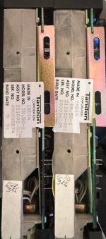

I do not have a 4P open, but I have a pair of TM50s (pictures attached for reference). Not sure which caps tend to need replacement, but there are (2) logic bds. main/digital on one side (2 tantalum), and motor control(6 electrolytic) on the other. Zion mentioned the cap loaded down the power supply, so I would suspect a tantalum.

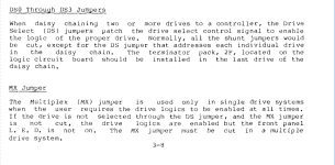

I would also like you to double check the Drive Select Jumpers and the Terminator. The Photo's
you posted doesn't show a terminator inserted. It should be inserted in the last drive on the chain.
If you use one Drive it should have the Terminator.
I have attached photo's of those two sections of the manual.

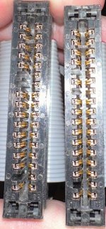

I expect the dip shunt to be set the same. In TRS-80 Model 1, 3, 4 4P, 4D, and CoCo, Tandy did the drive select in the ribbon cable connected to the drives ( removed the pins for the other drive selects), making each cable connector unique. It's possible the seek error occurs when there is a dead or missing floppy (I've not run through all possible scenarios, and I do not have a working 4P apart right now).
Neither drive in this setup has a terminator. I think the 4 series added termination/pullup at the main board (a little wrong, but simplifies things. This is an external pair of TM50s I had available).
You'll notice the cable connector is missing pins, that's how drive select is managed. (yours should be similar)
