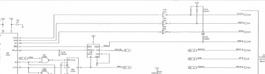

Probed the FD1793 chip (U13) and the voltage going to is good, 5v to the pin fifteen, this should be the step line, then it apears to go though some other logic chips before going to pin 20 on the shugart.
Yes, it's a Modem card with the Line connections.
If Pin 20 is ALWAYS LOW there is something wrong with that signal. If you Turn the Model 4P ON the
STEP Line Pin 20 should be HIGH (+5VDC). It should only PULSE LOW for a STEP Signal.
I've attached that section of the 1793 FDC.
Double check what you are seeing on Pin 20. If it is low on Power UP, then Power OFF and REMOVE
the 1793 FDC, and turn ON the Model 4P and test Pin 20 again. It should be at +5 VDC. Same for
Pins 18 and 24.
Larry
Pins 18 and 24.
Larry
Thank you, Larry! Got some information not sure how helpful.
With the U 13 chip removed, all of the lines that should read 5 V read .25 V - previously pin 24 was reading 4.7 pin and pin 18 was 4.7 and pin 20 was .25.
Now all three are .25
Going into the U 56 chip. Pin one has continuity with Pin 15 on the U 13 chip. Pin has continuity with Pin 20 on the shugart cable output. U 13 is inputting 4.56 into
Pin one. However, Pin two is only outputting a quarter of a volt. That is what I read at Pin 20 of the shugart cable.
Thanks

OK, with U13 REMOVED, Pin 20 is GROUND and Pin 21 should be +5.00 VDC. See what voltage is
on Pin 21. There must be something pulling down the +5 VDC. If Pin 21 is not +5 VDC.
Disconnect the Power Plugs to both floppy drives. And disconnect the 34 Conductor Ribbon cables
to both floppy's. Do you now have +5 VDC on Pin 21 of the FDC IC socket?
Larry

I reinstalled the FDC IC, and I have 4.68 volts on pin 21 with both floppies completely disconnected. Should I test without it in as well?
With the floppies having power reattched i get 4.72 volts at pin 21 of the FDC IC.
With the floppies attached, with power and the 34 ribbon cable reattached, I get 4.71 volts
Pin 20 of the FDC IC has continuity to ground
