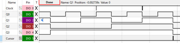

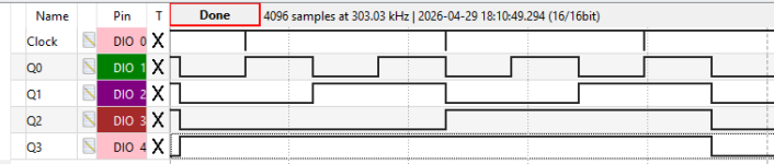

Unfortunately, I did not have time to get a scope on this last night. However, I'm looking into it tonight. But I have something better than a scope! (Hopefully) I have an Analog Discovery from my university days, which has a 16-channel logic analyzer. Now if only I had enough jumpers to use all 16 channels.
From IC4, we see that the counter is working properly. Interestingly, we're only seeing short pulses for the clock.
And after I also probed the cursor, we actually only see a short pulse, which while I don't understand, is what we want to see. I think.

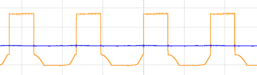

Okay, I have a theory. I was really confused by how the output of IC4 was hooked up to the cursor. Why is there a capacitor between them? That's weird, right?Perhaps we're using Q3/Do to charge or discharge that capacitor. So the capacitor is ultimately pulsing the cursor on. Perhaps it's taking too long to charge or discharge. Scope time! But I already have the Analog Discovery out, so I'll use that.
Orange is Q3/D0 from IC4, and blue is Pin 9 of IC5, which is the other side of that capacitor:
So we do get a brief pulse, but it's very brief.

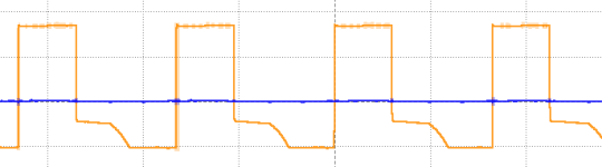

Here, orange is the cursor signal and blue is still Pin 9 of IC5:
What's interesting though is that now I'm only getting the cursor ONCE.

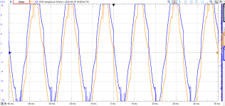

I probed across the capacitor C2, and I get two out of phase signals going on.
Very weird. I do think something to do with the capacitance and timing is at play here, but I'm still trying to figure out exactly what.
That secondary waveform seems to be the trigger for the enable pin somehow, seen in blue below:
Checking the frequency:
That's suspicious. This must be the 60Hz signal coming from the timing board somehow since if it were coupling to grid power it'd be much tighter (whereas I know the crystal is slightly slower than spec) and it'd be sinusoidal. This actually has me wondering how difficult would it be to make a PAL TV Typewriter. Anyway, I'm not sure if this 60Hz signal is supposed to be here or where it'd be coming from. I'll have to go back and study this schematic a little more. Maybe I have something shorted on the board that I haven't found yet.
