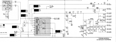

Can you post the schematic ?

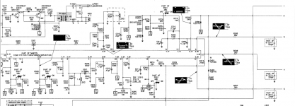

Yes, I have the whole thing. Let me know if there is a specific thing you're after besides what I post.
Thanks for you thoughts about this, I really do appreciate it!
I also thought of something else. When I first recapped the set, I noticed that the two big power resistors in the 5V source (RE14, RE15 18k) were super toasted and had lifted the traces from the PCB. I replaced them with new resistors and reinforced the connection on the back side with the solder. I've seen stuff like that on other sets and audio equipment just from use, but I thought I should mention it in case it's a smoking gun that I just don't see because of my lack of experience.
You can see the resistors on the bottom left of the PSU schematic. in the last picture I posted.

I'm still waiting on some of the parts, but I discovered that there is an inductor coil L521, which has an incorrect value from the factory. The schematic calls out 4.9, which is unusual because most of the inductors do not have a value stated at all, so that makes me think the value could be important. I am assuming that 4.9 means 4.9uh.
The value of the inductor that it's in the L521 spot is (I think) Orange-Orange-Brown, which I think is 33uh. It could be red-red-brown I suppose, but that's still 22uh. I wonder if the incorrect component could be causing this?
L521 is on the 178VDC supply and is on the neck board. It attaches directly to the collector of all three color output transistors.
