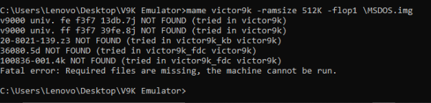

Hi Paul,
tried to get the emulator running, by doing the following:
- Downloaded MAME from https://www.mamedev.org/index.php on my WIN 10 64-Bit Machine
- Installed it
- Copied the V9K S1 ROMs (.bin Files) into the 'roms' folder
Trying to run the emulator with a bootable image (MSDOS.img) brings the following error message:
(The Image file is in the same folder than the MAME emulator)
- What am I doing wrong, where should I put the missing files?

Thanks to you both, I will try this tonight.
Best,
Martin.

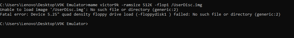

Hi,
downloaded the ROMs from Archive.org, now I tried it with a 612kB Disc Image (UserDisc),
please see the error message:
According to the error message, the Image file could not be found, currently I have the Image file in the same directory as the MAME Emulator, does it belong anywhere else to make it work?
Best and thanks,
Martin.
Martin,
You're passing in the path incorrectly. When you start with a / you're indicating this is at the root of the drive. If the file is in the same folder as mame, use ./UserDisc.img where the leading . is critical.
Hi Paul,
many thanks, sometimes a single dot makes the difference, now it works!
