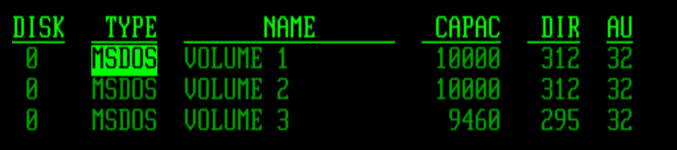

Using the same configuration (Tandon 703), I am able to boot from the hard drive. I didn't do the first step: I found you can just create a file with any old junk in it to start with, as long as the file is big enough. I installed DOS v3.10.
The attachment shows how I partitioned it.

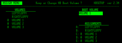

BTW in hdsetup, one of the partitions has to be marked as the boot partition. More of my setup:
Thanks for that. It was my boot partition was too large. I brought it down to 10MB and it boots successfully. I'm able to boot my actual vintage Victor into a 256MB drive, but there must be something different in the ROMs. I was able to format a 256MB drive, and have the boot partition be only 10MB and then it boots fine.

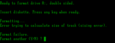

Floppy formatting doesn't seem to work - possibly expected with perfect media.
Yeah, that's never worked. The Floppy Controller implementation had major issues several years ago. I got it to reliably boot and read/write disk images, but never got to fixing the format process. There's also a few weird bugs where just reading double sided disks occasionally will cause a corruption of the underlying disk image.
