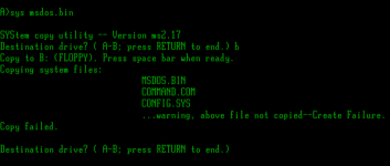

This old thread has got quite nicely revived!
Thanks for the interesting discussion which led me to trying at least to get a HDD version of the MAME V9K (Ver. 0.280) emulation running.
So far I reached this goal from two ends, using Westveld's image, which worked fine and creating a 'blank' image by pdevine's command
./chdman createhd --output victor_60.chd --hunksize 4096 --chs 695,5,17
Running the usual utilities (FACTORYF, etc.) did not bring any success up to now. I started the emulation with:
./mame victor9k -ramsize 896K -hard victor_60.chd
So far I could not make any use of it, I am sure I am missing a step or a command and appreciate any help.
I anyone has a >10MB HDD Image to share, I'll appreciate this as well! :-)
Best,
Martin.
If anyone has a >10MB HDD Image to share, I'll appreciate this as well! :-)
Hi Martin,
Here's a 256MB one. The assignment is:
a: 10MB boot disk from the HD
b: left floppy drive 1
c: right floppy drive 2
d: 246MB remainder of the hard drive
I've installed English DOS 3.1 on disk a: along with some other utilities.
Many thanks @pdevine !
I tried your image and was able to boot it. Once I was in DOS, I ran SHOWSTAT and this showed me the full size of 3800 cylinders / 8 Heads / 17 Sectors @ 512byte/sector equals your huge Hard disk of 256MB, very impressive!
What I've got in the emulation was drive A:\ => 10 MB, Floppy drives B:\&C:\ and drive D:\ => 19MB, please see Screenshot.
Any hints on this?
Thanks in advance!
