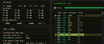

Hello everyone,
I've been testing how the hardware handles stack overflows during the unwinding phase.
I'm planning to include the asm below as a built-in educational example:

Here is a quick video showing the actual execution loop:
Looking at the execution loop, do the overall behavior and the unwinding path seem correct to you?
I also have a couple of questions regarding the UI representation (top-left window):
  • The "NEST" counter: This is just a software helper showing pending returns. It doesn't map to any real internal register. Do you think keeping this helps or does it just confuse newcomers learning the architecture?
  • The Stack layout: I discarded a modern "L1, L2, L3" list because it implies a push/pop shifting mechanism that the real silicon doesn't do. Instead, I went with a horizontal register array and implemented a visual pointer that follows the real 2-bit counter:
Does this approach feel right and make sense from an educational standpoint to you?
Thanks,
Jaime
The easiest way to think about the stack of the 4004 is to do what the processor does. One of the 4 registers is the instruction pointer. The other three could then be the return pointers. If your software emulation just keeps a pointer into the 4 ea 12 bit registers as the current instruction pointer. It will then work exactly the same as a real 4004. If you have a separate value as the current instruction pointer you'll always be wondering if you are using it right. This means that each instruction fetch is indirectly through one of the 4 locations. It won't be the most efficient instruction pointer you could have for execution but it would always work correctly.
As for timing. The 4004 was intended to control hard ware. That includes timing. Keeping track of how many clock cycles used for each instruction means that you can stimulate all kinds of simulated actions.
The current processors are so speedy that even with these overheads of emulating real hardware is a tiny price to pay. If you want to simulate the real speed of simulation you already have a handle if each instruction keeps track of how many clocks it would take.
Dwight
Thanks for the four-register perspective, one 12-bit address for fetch, three for returns, with fetch going through whichever slot is active in your unified model.
That’s the picture I had in mind for the overflow trace; in the workbench we still expose fetch as PC plus the three return latches below.
In the screenshot from my previous post, you may have only seen the return addresses (the three hex values, NEST 3, and the yellow marker). I’m attaching the full CPU WATCH window here: the PC sits above that row.
The system uses the PC for the current fetch address, while the three boxes below are the hardware stack slots. The arrow simply marks where the next JMS will write on that three-slot circular ring, not which address is currently executing.
Separating the PC from the three stack slots in the UI, rather than drawing four equal slots with a moving fetch arrow, was a deliberate display choice. Certainly not a claim about how one would lay out the physical die.
I’m curious whether you think this visual split is clear enough, or if it risks hiding the fourth 12-bit address when people only see a partial view.
On timing: noted. Implementing cycle-accurate timing is currently out of my reach for this phase, but it is definitely something I would love to tackle in a future version once the core system is fully stable.
If anything in that overflow loop looks incorrect compared to the behavior of a real part, please let me know.
