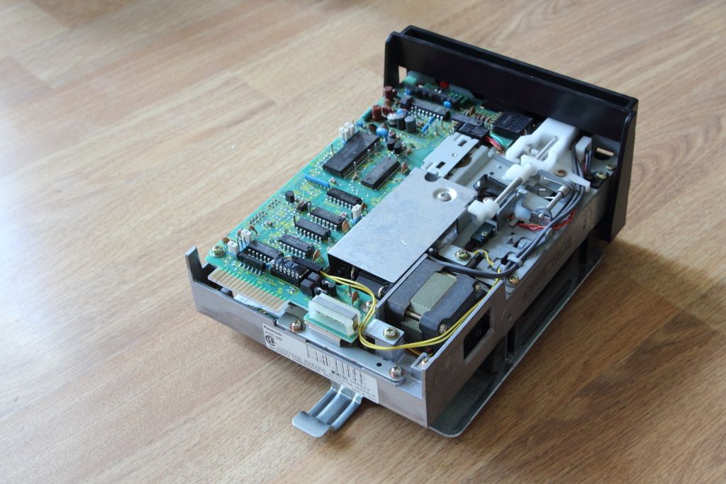

Well ultimately I may not use these drives due to ongoing issues. We've nailed down the software issues and I've extensively tested the drives on another system but something about the Wang......doesn't like them.
I've tried multiple combinations at this point and something about how the Wang handles floppy drives is weird. I can write out our known good boot disk from several different and known good drives and then booth the Wang. With a single drive installed 25% of the time it works. Other times it gives read errors again. Other times it starts to boot, then hangs. Other times it boots but it doesn't detect a disk change. (and yes I'm aware we have pin 34 held open but it's hit and miss if the DIR command makes the drive load the heads and check the ToC) You add in a second drive and the above still applies, but on boot you may or may not get the controller signalling both drives at once (remember, both drives are set to DS0, but you try and give then different DS selections and one or both drives go missing, so this seems deliberate on Wang's part) and things get lost in a read. Typically for me it's right at the same point and it will fail to load the printer driver and process config.sys, so instead of the fancy WANG logo you just get a DOS 2.10 prompt for the time and date.
Switch drives around, try different cables, add a termination resistor to the second drive (but Wang's being special and there's a dedicated ribbon cable for each drive rather than one long cable so I dunno what they are doing) fix cold solder on the power connectors and even replace the shunt sockets for the drive selects. Nothing fixes the problem. Switch out one of the drives with a half-height Fujitsu 360k floppy drive and tell it to boot from that. Flawless.
If I find more of the Tandon drives this originally came with I'll put those in but at this point if I keep working on this I'm going to rip out whatever is left of the hair on my head, so I'm setting this machine aside again.
Are this the original wang drives? The Wang can boot from drive A: or B:, not only from A:, that is the reason why it has two separate cables.
These are NOT the original Wang drives. PO bought the system to pilfer the drives for another CP/M machine and offered me the machine, minus the drives. These MPI drives are something I've had in storage for probably a decade now.
OK, the Wang Drives have an extra Microswitch to Check If the door is closed or open and that is necessary.

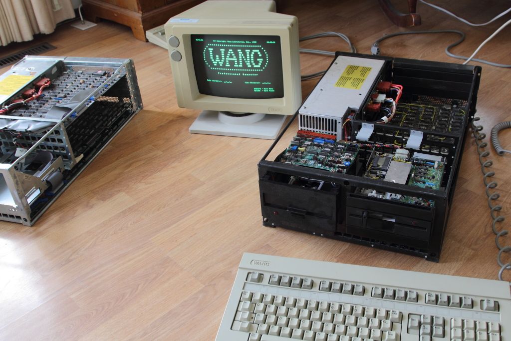

A second Wang PC has materialized.
The seller is a lurker here (or apparently word's getting out there's a computer guy in the Interior who regular's an AMC station wagon) and we crossed paths on FBM after it was for sale for a number of weeks but I bit the bullet last weekend and drove over to pick it up.
This one is in better condition. No memory expansion but it came with the IBM MDA emulation board (and the medium resolution monochrome display), one good half-height Panasonic floppy drive and a working 10mb NEC hard drive and Winchester controller, plus a mountain of documentation I need to scan now.
Slightly unrelated but last month I was given a pair of unrestored DS-DD MPI 5.25" drives so now we have the ability to try a different set of drives in the first Wang machine, as well as test against a floppy drive from another Wang that is known good and working.
The two possible replacements need some attention so I've oiled their spindle and head stepper bearings and I'll see if they free up but in the meantime I've pulled the first Wang PC out of storage so we can get back to this (RIP, chuck ;-; )

Okay so I got off my butt this weekend and tried a completely different floppy drive in the first machine to see if it was just that one model of MPI drive that it did not like.
I inspected, cleaned and tested an MPI 52SA and threw that into the system with the jumpers strapped for the first drive and a termination resistor.
Same result. The drive would sometimes boot and other times it would stumble or fail completely.
Well now I have a second Wang (Please don't judge) and it came from the factory with a Panasonic JU-455-3BBA so I swapped that in.
Just works. So that confirms that at least these MPI drives are not playing nice with the Wang's timing. I do have two more drives immediately on hand with half-height adapters but they both have bad spindle belts.
