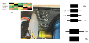

Testing the VTI that I have, I managed to get it working correctly again (meaning stable crisp font).
We thought it might be PSU related, so we tested that first. I know weird to have a tech ref here in sales/wanted, but in case anyone else ever needs to test/restore a POLY VTI S-100, here is the "works for me" VAC measurements I got across its 5-pin molex, and VDC values across the diodes:
The "fix" for my problematic characters was adjusting the left-side pot (the right side pot just shifted the whole video display left/right).
This might be a temporary fix, only because the card had been working fine, so still uncertain why it suddenly needed this adjustment. So this "fix" might not last forever.
Wanted to "archive" one more shot before I close things up. The big black wire in the foreground is the Composite video signal. Behind it is the main VDC diodes. And, that 5-pin Molex is "keyed"
