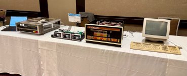

I spent the weekend showing off the 8/e that is skinned in the rare DECset8000 colors. My exhibit was next to George Wiley's and I am pretty sure we had the oldest two machines in the building. There was an Altair 8800B that might have been about the same age as Georges 8/m.
My display mostly focused on the CHEKMO-II chess program and quite a number of attendees took the opportunity to play the computer.
The 8 has 16k core, the RK8E controller, and an 8255 console serial interface running at 19200 baud. The Wiley RK05 emulator was the boot device. I brought along the PiDP8 as a backup in case the 8/e would not run after traveling 1500 miles (2400 km) in the car. I didn't have to use it. The screen, keyboard, and Raspberry pi were running my console serial disk program as a glass Teletype.
I think the overall tally was CHEKMO-II having 9 wins, 4 losses, and 4 draws. In its blitz mode it is unable to find a checkmate with 2 rooks, and 6 pawns vs only a king. It simply does not look far enough ahead. Swap one of the rooks for a queen and it does manage to eventually get the win.
It was a good weekend, I got to meet George Wiley. Vince also and one of my college friends also attended. The show itself reminded me of the first VCFMW I attended in 2017 I think. Similar in size and attendance.
...and right next to Doug is my PDP-8/m exhibit. Thanks to Doug for arranging to have our tables next to each other so we had the "PDP-8 corner" of the exhibit hall. Lots of folks seemed interested in what were some of the oldest computers in the show. There are two things happening here, on the right is the 8/m connected to two RK05 emulators and a VT-420, and on the left is an RK05 emulator configured as a Tester which is exercising the Diablo Model 31. My laptop to the left of the drive has Putty running as the console to control the Tester. The graph visible on the screen shows the Diablo seek time vs change in cylinder address (which I measured some time ago). I made a plexiglass cover for the Diablo so it was possible to see the inside of the drive while it was operating.
