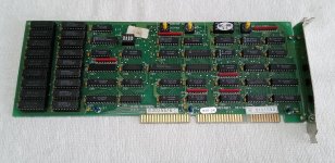

Hi everyone
Well this is just 1/2 a mystery board because it is clearly a 16 bit memory expansion card
I cannot find any information in the internet about this
It is marked "Megabit V3" but nothing popped up... not even the supposedly company name Megabit ....
If someone is familiar with this kind of cards
It has some knobs to set the memory amount and start address I think which is very interesting
Apart from that seems a very generic expansion cards for the 286XT and 286 computers
Thanx

"Megabit" is terrible branding. Like naming a tire "PSI"...
It looks like a combo expanded/extended memory card. See here.
Is there an FCC I on the reverse? Often a guide to the real maker.
Don't need too, its definitely DFI by the rotary switches. This one would most likely be one made around the time of the 386sx, hence the larger memory size DRam... I knew DFI moment I seen it due to those rotary switches and PCB color.
The item in the image is a vintage DFI MEGABIT (Revision 3) 16-bit ISA Memory Expansion Card. [1]
Manufactured by DFI (Diamond Flower Inc.), this legacy add-on board was popular during the late 1980s and early 1990s for upgrading the system memory (RAM) of IBM PC/AT, 286, and early 386 computers. [1, 2, 3]
Key Technical Features
  • Interface: It uses a 16-bit ISA (Industry Standard Architecture) gold edge connector to interface with vintage PC motherboards. [1, 2]
  • Onboard Memory: The left side features sockets populated with DRAM DIP chips. The chips shown are Goldstar (LG) GM71C256 variants, meaning each chip provides 256 Kilobits of storage. Grouped together, they form banks to provide Expanded Memory (EMS) or Extended Memory (XMS). [1]
  • Configuration Knobs / Dials: The distinct yellow rotary switches (dials) at the top of the card are used to manually configure the starting memory address and the amount of memory allocated, eliminating the need to set complex rows of jumpers manually. [1]
  • Onboard Components: It includes discrete logic chips (such as 74-series TTL logic) and resistor networks (the red vertical bars labeled RP) to handle bus timing and address decoding.

I disagree. There is no record of DFI producing a memory expansion card named Megabit. Only MegaLITH, which is completely different. There is nothing distinct about a green PCB. What are the other DFI cards with rotary switches? Every DFI card I have seen has jumpers or switch blocks.

I sit corrected. I would still be interested to know what other DFI cards have rotary switches.
The MEMO 2000 XT also had rotary switches, as well as one with 30 pin simm slots that the name escapes me atm. I never seen another brand card with these yellow rotary switches otherwise. Believe rev2 of this card also had the same rotary switches, but its been years. Glad I was able to help. Seems year by year I forget more. I repaired so many different machines in the 90s when I worked in a PC repair shop.
The MegaLITH Plus has SIMMs but uses switch blocks. I have a few of those cards. Maybe there was an earlier non-plus version.

Gosh thank you so much for the help
I'm going to try to install the card with this drivers on a 286 machine with just 512mb to see what gives
And yes Megabit ... is like branding your cake "yum yum" good luck googling "yum yum cakes"
Thank you so much !

Thank you for the help my friend !
I had no idea DFI was that ancient ... I thought they ere more of the socket 3 / socket 7 era
Looks like they were not very proud of their product to not print their name anywhere ... :(
Well, it's Megabit REV3, not Megabit V3. Seems to not help much in googling, but still.
Is your goal to figure out how to use the card or in particular to figure out who made it?
The I/O port switch hints at it being able to do EMS in addition to XMS might be an issue since I would guess that you need to configure how much to allocate for EMS v.s. XMS.
Otherwise the two other switches seems to set the starting address freely at 128k intervals, so would be easy to test the XMS functionality in any 16-bit ISA computer that has less than 15-16M RAM on board (or one where you can designate a "hole" in the memory space, for 16-bit ISA cards).

Yeah my main goal is to be able to use it as it is intended
I have always been told that this kind of card needs the correct DOS drivers to be able to operate
But I already got some hints here in the comments and as soon as I have time I will test it ... maybe this weekend
