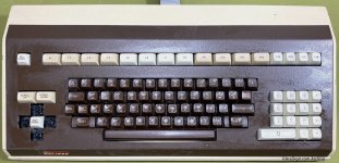

One of the rarest items in my collection is a keyboard for a computer/word processor made by DHL, the renowned carrier!
When DHL expanded into the Middle East markets, it required a computerized system to facilitate printing and communication in the Arabic language. After searching for a ready solution, they couldn’t find one, so they decided to create their own! The result was the DHL 1000 word processor, which was introduced to the market in 1979. The company utilized the system in its offices in the Middle East and also offered it to local companies there.
A sketch concept for the system during the design phase.
The system comprised:
  • CPU with an RS232 port for communication
  • storage unit with two or four 240KB disks
  • bilingual daisy wheel printer
  • terminal with a 12-inch 90-character wide CRT and keyboard

The DHL 1000 preceded the IBM PC by a couple of years. The system targeted clerks and secretaries, and hence no programming language was available for end-users AFAIK. It was a closed system with only three main applications available: word processing, “manifesting," and billing.

According to DHL documentation, "by 1984 over 500 machines had been deployed in DHL offices." The company also sold the system to other companies, so it’s reasonable to estimate that approximately 1000 machines were produced.
I think it'd be around 1560 computers produced.
