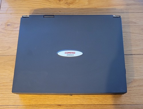

I would get DOS laptop, one of this:
Compaq Amada 3500:
or (if you don't care about Neomagic video card and proper screen strech)
Sony VAIO PCG-505G:
I have PCG-505G in my collection and like it.
I have seen a few interesting laptops locally, but they don't scratch my nostalgic itch as I had beige towers back then, not laptops.
