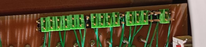

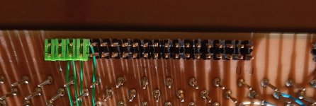

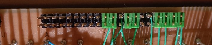

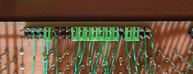

Here are some pictures of the jumpers:
X13:
X12:
X11:
X10:
System Revision: XXN
XX = Number
N = Symbol
J = Jumper DEC-Alphabet
No Jumper equals 1!
Order on Backplane
etc. <- J12 <- J13
XX:
J13 - B -> not set -> 1
J12 - VV -> not set -> 1
J12 - TT -> not set -> 1
J12 - RR -> set -> 0
J12 - NN -> set -> 0
-> 00111 -> 7
N:
J13 - L -> set -> 0
J13 - J -> set -> 0
J13 - F -> set -> 0
J13 - D -> set -> 0
-> no sign in revision
0000= NO LETTER 1000= J
0001= A 1001= K
0010= B 1010= L
0011= C 1011= M
0100= D 1100= N
0101= E 1101= P
0110= F 1110= R
0111= H 1111= S
--> VERSION 7.0

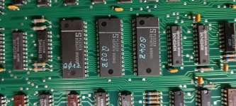

The ROMs at the CIB have some markings, but I don't know if this is helpful finding the issue why our VAX do not want to communicate with our PDP-11.

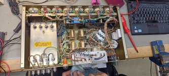

In the meantime we also had to repair the main power unit which distributes the Mains to the Power supplies. There we found a burned resistor and a faulty zener-diode.
Those PLS101N are afaik PLAs and not ROMs.
I.E. they likely replace a lot of regular 74xx logic chips.
If there are any ROMs they are likely somewhere else.
