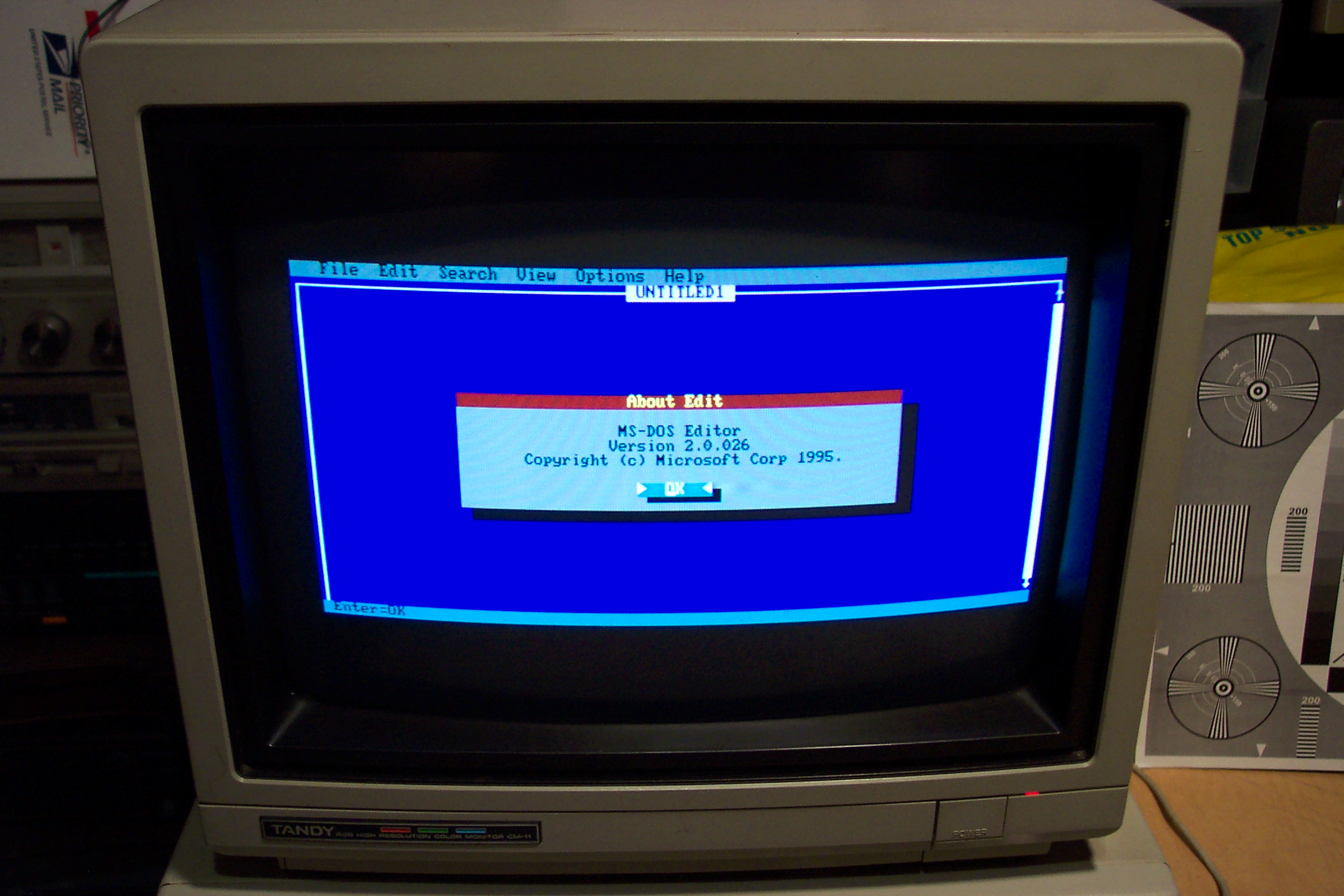

I just installed a Sound Blaster Pro card in my Tandy 1000SL and I was dismayed to discover that the GLX MOD file player doesn't support CGA. I could hear the music playing just fine, but all I got was a blank screen. But before I installed a VGA card, I wondered what would happen if I switched the Tandy's onboard video into MDA/Hercules mode by pressing Ctrl-Alt-Shift-V, while still using my Tandy CM-11 CGA RGB monitor. Mind you, it's not supposed to work, because MDA outputs its video on pin 7, while CGA monitors ignore this pin and use pins 3, 4, and 5 for Red, Green, and Blue, respectively.
But to my surprise, after adjusting the monitor's controls, I got a steady, clear image! The top line and left side were cut off a bit, but the majority of the screen was perfectly readable. It was even showing on the CM-11 in the obligatory green phosphor color! (click for hi-res photos):
The odd thing is that some of the vertical bar characters appeared to be gray, instead of green. It didn't photograph well, but here's a close-up:
And here's the kicker: the CM-11 monitor doesn't even have pin 7 connected to anything -- it's missing from its DE9 connector. So, clearly the Tandy is outputing MDA/Hercules video through the RGB pins... and perhaps could even be emulating the early IBM MDA cards with the "color MDA" RGB output? I know it's also outputting video on pin 7, because I've connected a real MDA monitor to it and it worked fine.
Just to prove there was no trickery involved, here's the same CM-11 monitor showing proper color CGA video -- it's squished down to the center of the screen because that's how far off I had to adjust the monitor's controls to get the MDA video to display properly (or at least as properly as it could manage):
I had the CM-11 running with the MDA signal for nearly an hour with no apparent ill effect.

The Tandy CM-11 is not a multi-sync monitor; it just happens to have a wide enough range of its V-Hold and V-Size controls to be able to lock onto an MDA/Hercules video signal. Here are the CM-11's official specs:
http://support.radioshack.com/support_accessories/doc6/6012.htm
I did some testing with my multimeter, and in MDA mode the 1000SL is putting out video signals on both pin 7 (the normal monochrome pin) and pin 4 (the CGA green pin). There are no signals on pins 3 or 5 (red or blue) in MDA, so what appears to be "white" on the monitor in MDA mode is just an artifact of the color CRT pixels.
And in CGA mode, in addition to the normal RGB signals on pins 3, 4, and 5, it is also putting out a signal on pin 7, the MDA video pin.
I wonder if this is normal behavior for most switchable CGA/MDA video chips -- to keep both the RGB and monochrome video outputs active in either mode, and only change the scanning frequencies? That certainly simplifies the design, and causes no problems in normal use, since CGA monitors ignore pin 7 and MDA monitors ignore pins 3-5.

There was no audible whine from the monitor's oscillator, like what you get when trying to display a video signal a monitor or TV can't handle, such as trying to display Super VGA video on a regular VGA monitor.
