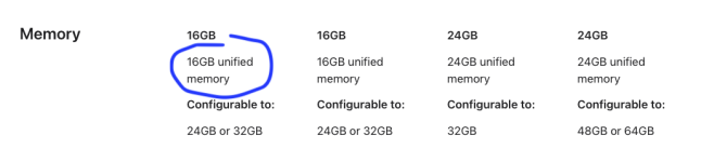

Apple never called their system "UMA,"
Do you mean the ones they sell today that everyone else calls "UMA"? Oh, gee, you're right, on their tech spec page they leave out the "A".
And yes, the term wasn't around in 1977, it's a retronym, and an imprecise one at that. The fact that it bothers you so much is fascinating.
