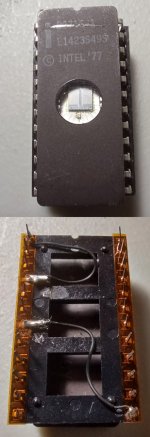

One of the 2716s came in this socket...
If I am reading the datasheet right, this socket, with the heat-resistant tape, connects GND to CE (so it is always on), and Vcc to Vpp, which the data sheet says is fine, except that it is rather rather inconvenient if you want to program it. I was able to remove the socket and reclaim the chip proper.

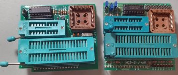

I got it in my head that I wanted to program an AT89S52 using the Willem and the adapter on the right, which came with my set up.
I could find almost nothing about this daughter board, save a picture here and there, e.g. here. If any one has any information, please pass it on.
I believe that this 'newer' board is called Version 2. With no instructions at all, I proceeded to try to program an AT89S52 and it simply could not be done (by me). The picture in the Willem software shows the board on the left (not the one on the right) but has a check box for "New Adapter" - that made no difference.
I believe that the board on the left is the older version and is what is depicted in the software. I picked one up and was able to program the AT89S52 without any problem.
