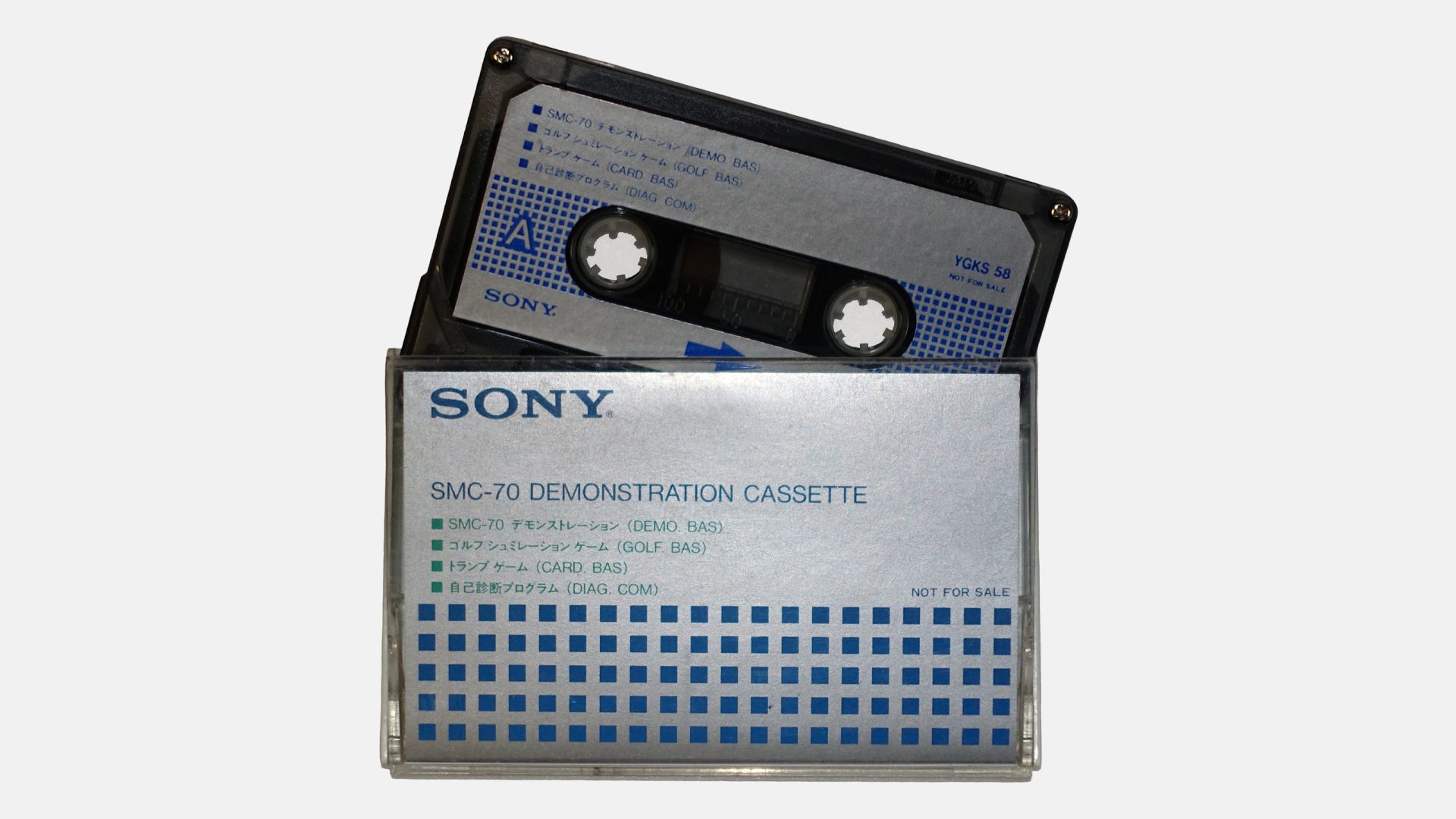

I came across information that the SMC-70 came with a demo program on an audio cassette (does anyone still have it?) that demonstrated the capabilities of the device. I can assume that the only way to boot this cassette was from the built-in ROM BASIC, which is another reason why it would have been good to have it.

I have the tape deck, but I have never found the demonstration cassette (I wonder if it only went to dealers). The only cassette program I have ever seen was char.bas included with the emulator. I assume the demo.bas program is the same one included with Sony BASIC, though I am curious what the golf program is. I don’t think software was ever released in the US on cassette (don’t quote me on this, though I’ve never seen any). My guess was the cassette option was included for potential home use (there were games released in Japan on cassette; Battle Hanafuda from Dempa was one I know existed), but part of the appeal of the machine was how cutting edge it was (though floppies at $5 a piece was the price to pay for being cutting edge, or ~$17 today).
