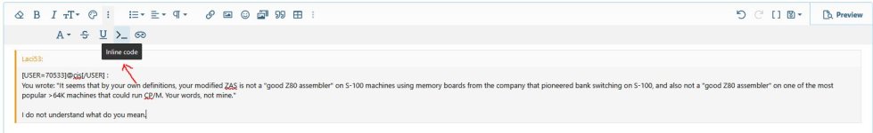

That code you posted is unreadable to due to being reformatted as natural-language text. Try putting it in a code block. (If you can't edit that post, the edit window has expired and you'll need to make a new post.)
He means click on the vertical ... hamburger and then on the >_ and then select inline code while highlighting the code.
Capture.JPGIt makes the code look like this;

You should be able to go back and edit the post and make it like that - :)
It just makes it look nicer and is a little more readable. (edited, my addition was confusing... I responded to the wrong post)
