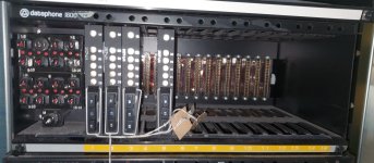

Rackmount cage 40A that held up to 8 circuit packs.Screenshot 2025-12-14 at 11-43-52 590-010-202_I2.pdf.png
Found a 40B1 rack. Modifying it from 16 202T to 6 212A 300/1200 modems and 801C ACU.
If anyone has a 40A series rack, I could use pics of positions 6-8 as these were wired specially for shared ACU usage.
Note: To reduce labor costs, Western Electric used flexible circuits instead of wire wrapping each connection. :)
