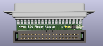

I see someone has already done a DB37 to IDC-34 disk adapter, https://adafruit-playground.com/u/jepler/pages/xerox-820-gotek-adapter, but I think I'm going to a version more like my vertical Apple III design that pulls it closer to the port, https://www.tindie.com/products/tersteeg/apple-iii-to-fujinet-or-floppy-emu-adapter/

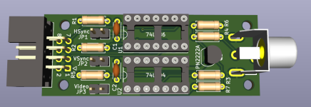

Also need to respin my parallel to PS/2 keyboard adapter, https://github.com/djtersteegc/ferguson-ps2-keyboard-adapter, for the DB25 port and probably do something for the vide port that combines the two separate sync signals into a composite output so I can use the same CRT I use with the Ferguson.

Floppy Adapter
Decided to go with the edge mounted DB connectors so they can be secured to the ports with screws if desired.
Video is going to need a bit of circuit experimentation so I need to wait for my power plugs before I can tackle that and get this all shipped off to JLCPCB.

Floppy adapter with a custom power cable for the Gotek running Flash Floppy firmware.
As I feared, the composite adapter will need more work. It produced a picture, but sync was was off. Future fun.

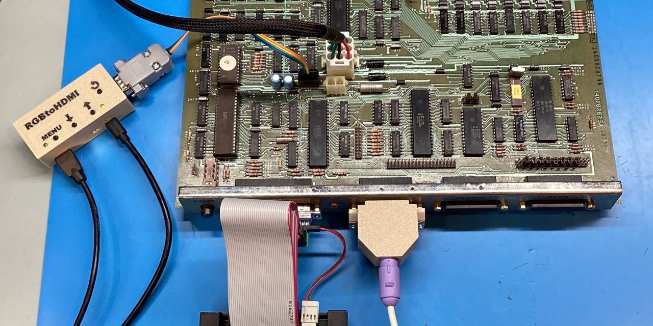

So on to plan B and building a cable for an RGBtoHDMI with the CGA/EGA TTL buffer board. Still need to tweak the config a bit, but got a stable picture so I could do some more testing with various disk images.
