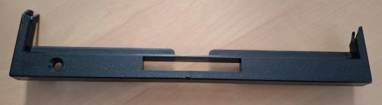

1. Front bezel
The black front bezel is broken at both ends, especially around the mounting and retaining features.​
I still have most of the part, but I need photographs of an intact bezel, particularly:​
  • front and rear views;
  • close-ups of both ends;
  • mounting points and retaining clips;
  • overall dimensions;
  • thickness of the plastic;
  • dimensions of the LED opening and central button opening.

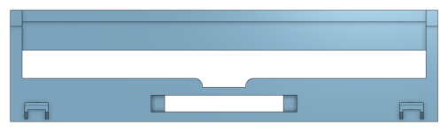

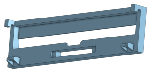

I have now completed a first CAD reconstruction of the front bezel based on the remaining parts of my original one.
Some areas, especially the damaged ends and retaining features, had to be estimated. I have attached several views of the current model.
04_YD180_bezel_V0_rear.png05_YD180_bezel_V0_rear_iso.png06_YD180_bezel_V0_side_section.png
It would be very helpful if you could compare the original bezel with my reconstruction and take photographs of any details that appear different or missing.
I have not reproduced the hollow cavities on the rear side of the original part. They were probably intended to reduce the amount of plastic used. For FDM printing, keeping these areas solid makes the replacement stiffer and should not affect its function.
Thank you again for your help.
Best regards,
Romain
